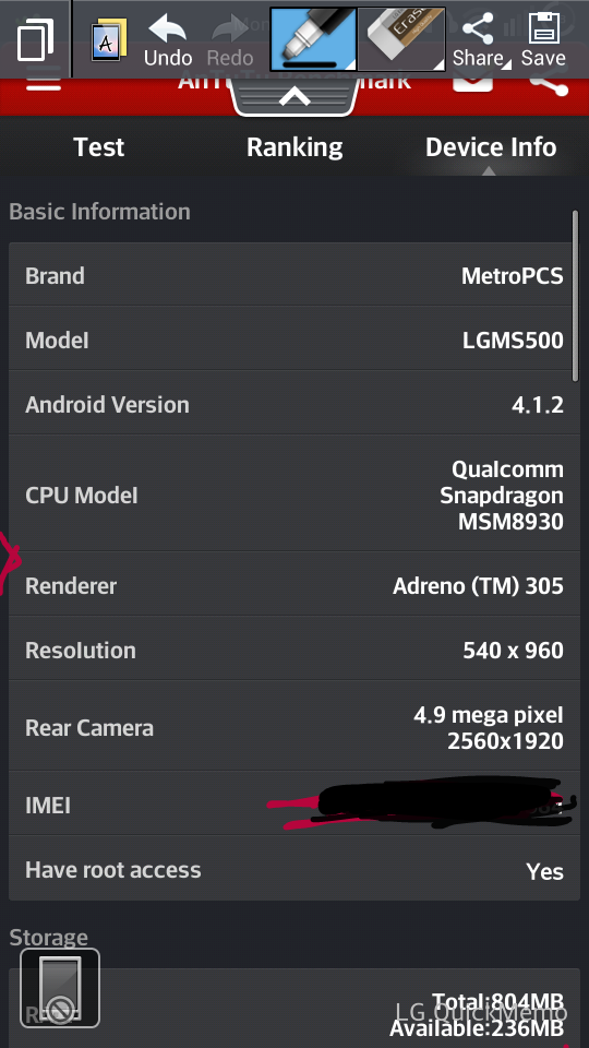

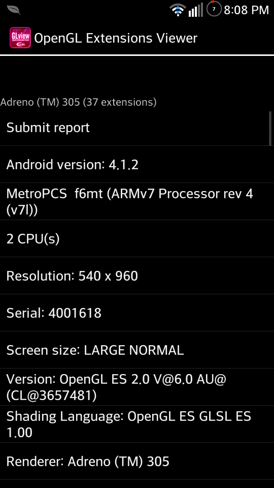

Yep CPU-Z says 305. Go with the 305 maybe the logcat isn't detecting it right.
wtf is the bull**** lol, LG gives the f6 and f3 adreno 305 and gives the f7 225? lol excuse me for lurking. Btw cant u check via /system/lib/egl?

Yeah looks like we have been fooled the entire time
I believe it was a mistake on behalf of LG. They probably made a mistake in the there but the actual chip is Andreno 305. Andreno 200 would never give us high benchmark score "graphic wise". And not to mention play games like GTA San Andreas lag free. There is no way we have Andreno 200. That GPU is mostly found on Gingerbread single core devices and it just would not be able to handle running Jellybean and on top of that play high demanding games. Not to mention our limited 804 MB of RAM which thanks to our LG Skin is always running low. And our CPU is not really that good. I had a device 2 years ago that has a better CPU than what we have.
Now since all the apps identify this device as having Andreno 305. There must be a other way which ultimately tells them that this device has that specific chip.
