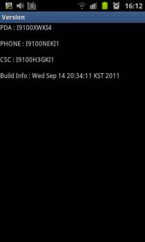

I am a bit confused now, I think the file you sent is for the stock rom that I am on now. please check attachment.
what would i gain by flashing it?
rooting the phone?
getting rid of the bug?
or you have given me the back up that i needed to restore to if i got into trouble by flashing the beta version of this kernel that solves the aos bug?
sorry guys i am so new to this..

I am trying to give you a good working edition of the "3" firmware you tried to flash via Kies.
I would suggest doing a Factory reset before flashing the firmware via Odin to get rid of any detritus from your present flash.
This will wipe your phone but you will be able to re-sync your contacts and calendar via Google as well as most of your app's, via the Market.
Hope this helps. :D
