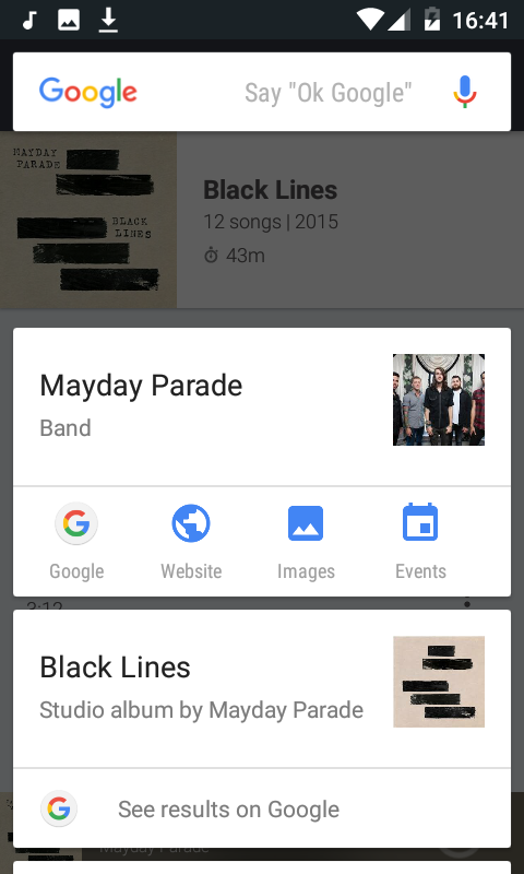

Now on tap not working and I don't think it is ROM problem. I think the problem is from gapps package. Any idea?
Now on Tap is working. I tested it with Eleven.
* 01/05 ver cm13, 01/05 pico gapps from open gapps. I downloaded the Google app and GNL from Play Store.
