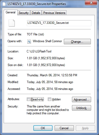

Item 1: The tot file!:1.17 gb! remember to backup efs parition and do a full nandroid asap! Note this is the boost file but it seems that simply activating the phone will download proper firmware to modify it to respective carriers.
https://mega.co.nz/#!lAImESRI!fzpKjwS5n0cV73BMkUQNLAUk73xE6lmcc4UmeaDdorE
Hmm....the file that downloads is 1.81 GB, not 1.17. Is it possible that there is something wrong with the file?
EDIT: Wait, that would be the extracted file size. God, this has me so frazzled, any indiscrepency has me jumping, lol.
