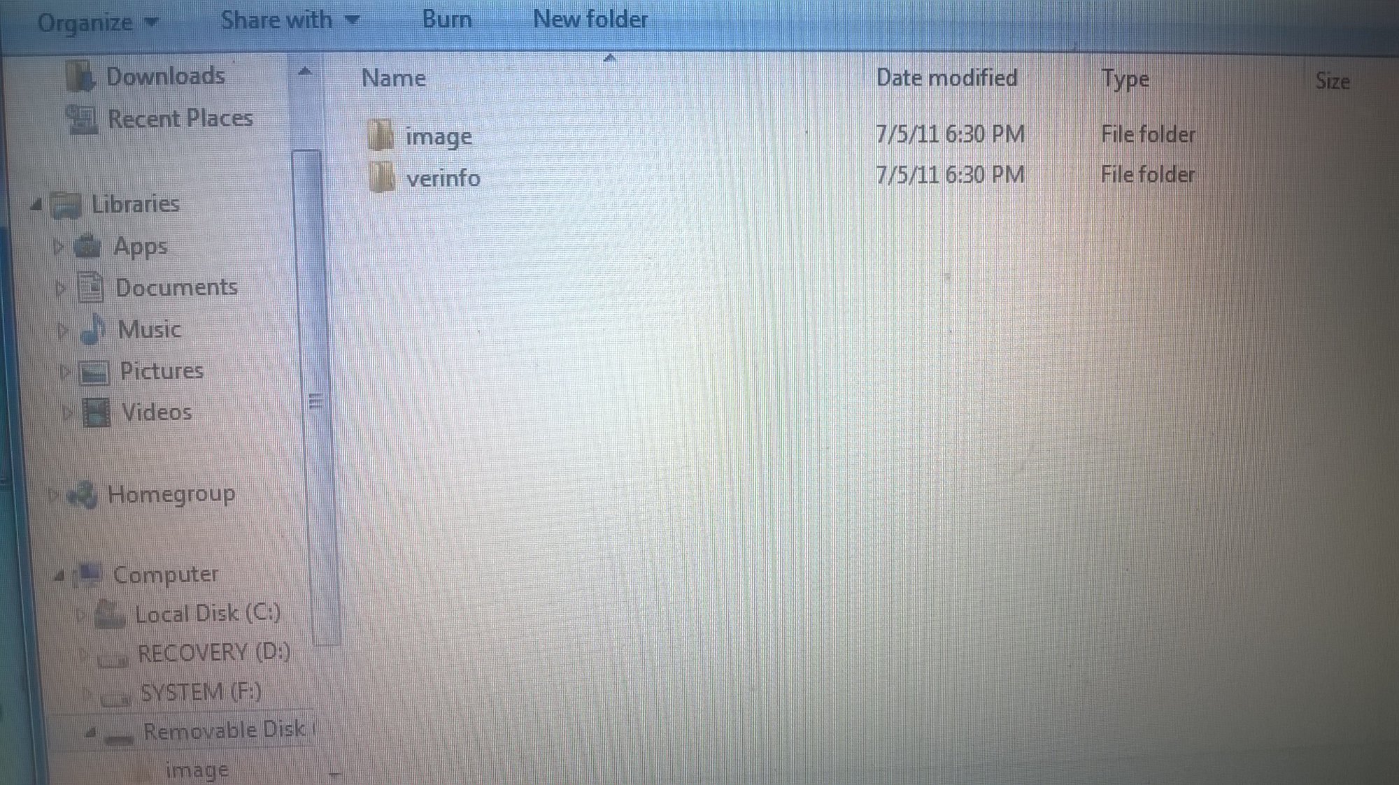

I need some help I've had my LG volt bricked for a couple weeks now and can't seem to figure it out I flashed a rom that I didn't notice was for a different LG phone and now my phone only shows a black screen no dl mode no recovery just black and when I connect it to my computer a mass storage device pops up an only a file called image and a different one shows up I need help if there's any fix for this
Doubt it. You need to be able to interact with it to fix it, and you can't.
Well is there anyway to have a debrick img on a SD card and make the phone boot from that when plugged into my computer it says removable disk and it shows 2 files
Could you use the way they use on this http://unleashedprepaids.com/thread-9089.html
