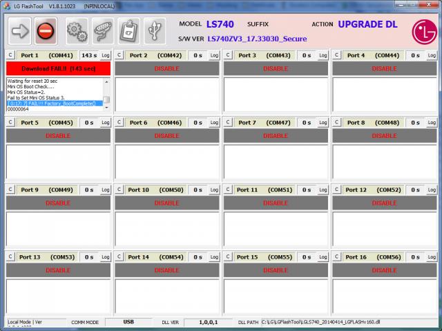

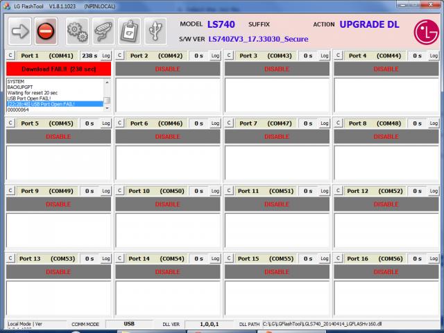

Result using the recommended drivers, still status 2. I don't know where this 'after 15 minutes' is coming from because the whole process fails after just under 4! asmugone, please get a hold of me to arrange a remote session! I don't want to use my crappy backup phone anymore! :(
Attached the beginning and end of the log file. Hope someone can see where this is going wrong!

OMG! So I noticed that in the last screenshot it seemed to be implying that it failed to change the status because the phone had completed a factory boot. So, out of pure desperation, I waited for it to get to 99% flash on the phone and started holding Vol+ hoping it would reboot straight into download mode. When the LG logo came up, I held down power too to attempt to prevent it from getting to the mini os screen. When it rebooted, it went to a different factory data reset screen. I told it to do it, and now it rebooted like nothing was ever wrong! Phone fixed! I have no clue as to why it worked differently then what asmugone said, but I have my phone back! Hooray for desperately smashing buttons!

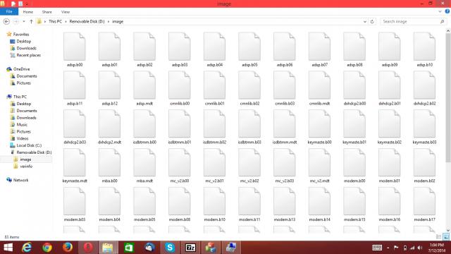

Does anyone know how to restore the phone when the screen won't turn on? I try to push every button on the phone and it will not turn on. However, when I plug it into my laptop. The phone shows up as a removable disk with two folders that have some files in them. That is all that shows up, nothing else happens. I cannot get the phone into download mode.
EDIT: Well, if I unplug the battery and plug in the USB cable, it shows a screen showing the battery is disconnected. I cannot get past this part.... :-/

What files do the folders contain?? I haven't tried this but I imagine that would be useful info
I will upload them as soon as my phone gets unbricked. I cannot waste my friend's data on his phone because he only gets 3GB of tethering and he can't bypass it.
