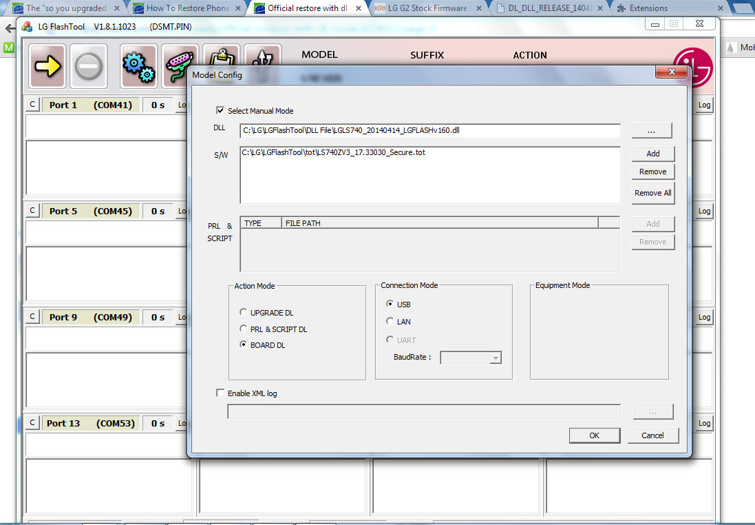

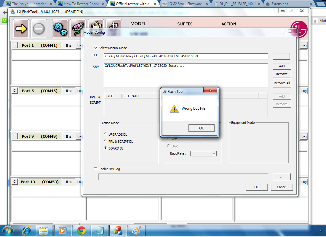

"4. Launch the program [First Time It Makes You Select A Mode Pick The Third] and click manually select dll."
I did not get a "select a mode" prompt.
When I selected a dll (either csmg_reg_key.dll or MegaLock.dll, the only ones there) I get a "Wrong DLL File" error.
What am I doing wrong.

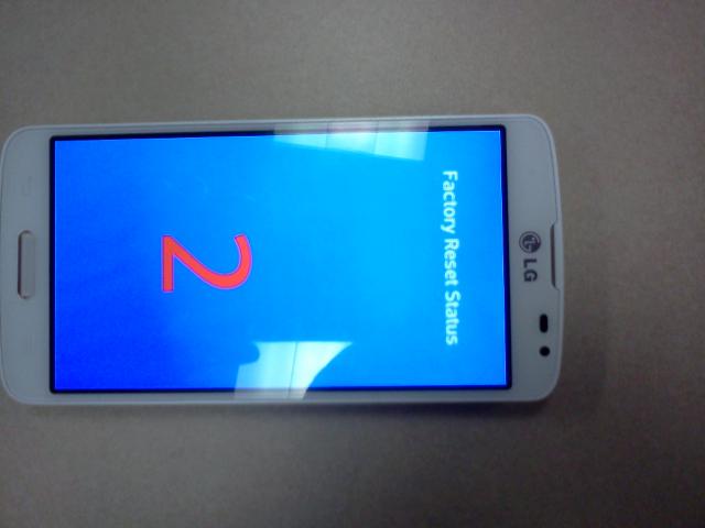

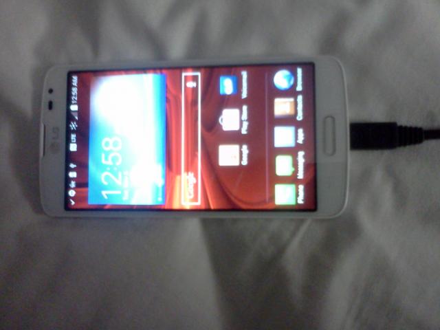

OMG! So I noticed that in the last screenshot it seemed to be implying that it failed to change the status because the phone had completed a factory boot. So, out of pure desperation, I waited for it to get to 99% flash on the phone and started holding Vol+ hoping it would reboot straight into download mode. When the LG logo came up, I held down power too to attempt to prevent it from getting to the mini os screen. When it rebooted, it went to a different factory data reset screen. I told it to do it, and now it rebooted like nothing was ever wrong! Phone fixed! I have no clue as to why it worked differently then what asmugone said, but I have my phone back! Hooray for desperately smashing buttons!
All I can say is freaking wow!!! I also fixed my phone from that status 2 blue screen using the factory reset method by holding the vol+ and power button once the LG logo screen came up during the reboot.

1. Using the factory reset method mentioned above after the phone reboots in the LG flashtool (vol+ and power button pressed together (or maybe even vol- and power button???) , I probably went through like 10-15 iterations above before it finally didnt go to the blue screen and returned to normal. I also said yes to wipe everything once in factory reset menu.
2. The LG flashtool status still showed up as FAIL even though my phone ended up resetting itself back to normal.

I also attached pics to show that i really did get it out of the blue screen in case someone is losing faith out there. . .

Good info bouncerhvj, but we're past this issue now. The problem was that when flashing, you need to use BOARD_DL more rather than UPDATE_DL mode. :)
