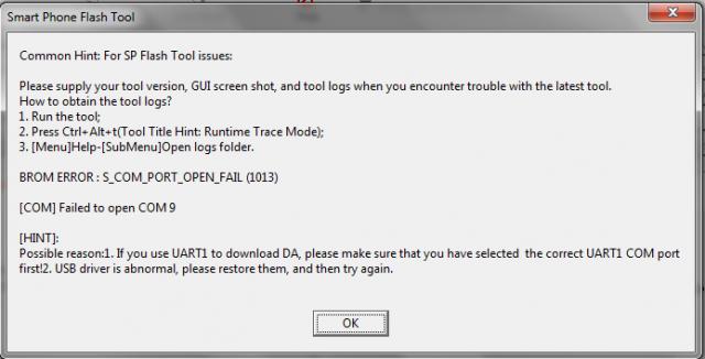

I tried the flash tool, but nothing happened when I clicked Download
Your phone needs to be turned off, the battery removed, then re-insert the battery, then re-plug into the computer without turning it on. I learned this too, let me know if it solves your problem and I'll update my long post
Sorry for all the later/afternoon replies, I would normally teather my phone to my laptop at work on lunch and breaks but... lol, so only afternoons/overnights/early morning for now :P
Nope, nothing happens, it just says "searching" on the bottom

OK, I actually got the download started, but I took the battery out before the phone was recognized. But, I got the attached window
I would test out your cable to start, try just start sending like a gig or two of movie over to your phone and start wiggling stuff until things fail :)
It's not the cable, I tried many. :(
I can't send anything to my phone because it's soft bricked...it only goes to the T-Mobile splash screen and stops there.
