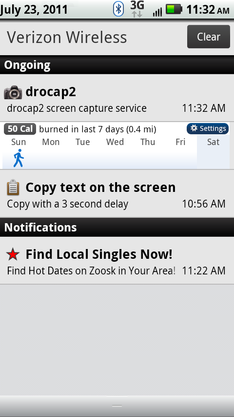

Possibly that airpush ad system. Might be an app that is using this.
"A slowly growing number of Android app developers have chosen to adopt AirPush, an advertising system that places ads in the Android notification window. "
I believe there is an app in the app store called airpush detector. Might want to check into it.
That's the only thing I can think it might be...

That's exactly what it was! I had 2 apps that had that crap on em. Thanks for the tip and telling me of that app on the market to get rid of em! I think if someone downloads alot of apps, they need that one that detects that air push crap.

I struggled with this for months. It was not Airpush, I installed all of the apps. I just solved my problem. The ads are placed by an app called Download Manager. Remove it and the ads go away.Anyone else seen these? How do you get rid of them?
