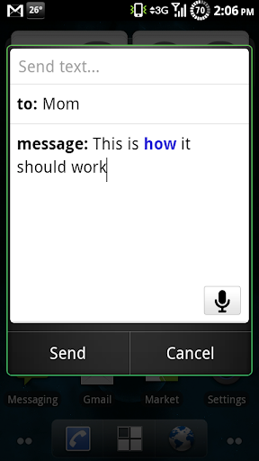

And just to be absolutely certain, you guys are saying the command like this, right?
"Send text to Mom, message This is how it should work"
Upvote 0
I'm not saying "message", I never had to in the past and it has always worked. Even "Call Jamie Home" does not work.
Edit: I tried saying it exactly as you did and this is what comes up. When I say "call mom home" I get what comes up in the second pic. Hopefully we can get this figured out, I use it a lot while driving.
