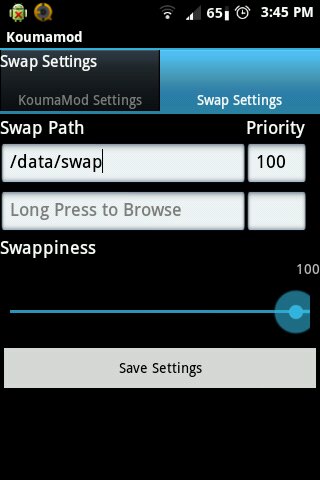

According to Kouma, the swapiness should not be more than 60 !!
I never played around with swap settings in koumasettings, but Kouma posted his own settings and here are the pics ( but he uses DATA and not SSM) :
mine is set at 60 and i run swap ssm, but have 4 partitions, one for just swap, his says swap but mine goes to the swap partition, don't know where his at just swap goes? might be a file instead. mine is super fast at all times, anytime.
Kouma uses also a partition for swap... Look at the first pic of SDparter.... It's a 2GB swap partition..... ;)
yeah, setting your swappiness to 100 makes the phone prefer the swap partition over the actual memory. drop it to 60 or less (i use 20) and you'll probably run a lot better.
Ya 20 or 30 what I use too. Class 10 card tho. They got class 10 16gb cards on Amazon for 15 usually
