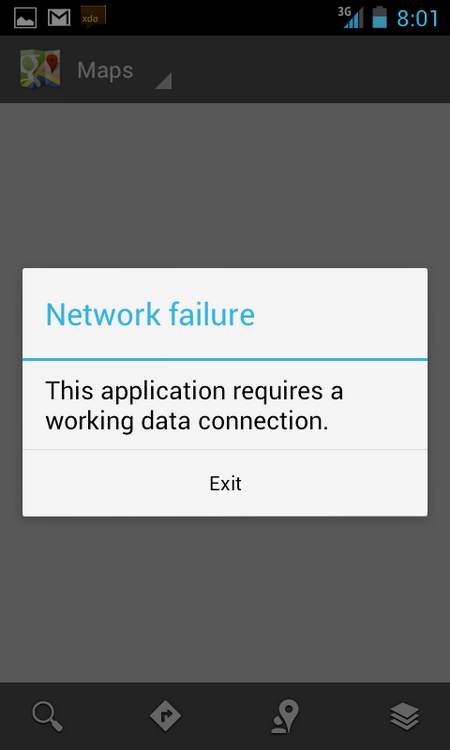

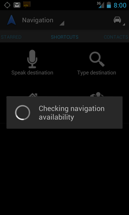

Well, I'm having some issues this morning using GPS and Maps. I tried to start up Google Navigation which prompted me to turn on my GPS. I enabled GPS and went back to Navigation. The whole time I never received a GPS signal, gave it a good 20 minutes. So I decided to close navigation and just use the Maps app to find out where I needed to go.
When I opened Maps, it errored out stating I had no network connection which was false, as I could run a speedtest which confirmed 3G connectivity. I tried to toggle airplane mode which didn't work nor has a reboot. I've taken screenshots of said errors as I've never seen them in these 2 apps before. Other than that, I haven't had any other issues to this point.
This is the first time using Maps and Navigation on this ROM if that's any pertinent info.

I haven't seen this before, but I have seen install issues with Gapps. A few times when Maps or other apps that use maps was erroring out, it was because the google maps jar in frameworks was corrupt. I don't know why, but after looking at the file it was smaller than the one in the Gapps zip. So I copied to the correct place and everything worked again. I don't think this is the problem you are having but I have no idea what is happening. If the problem persists go to recovery and flash Gapps again. Sorry I can't be of more help, but you seem to be the only one to report this issue.

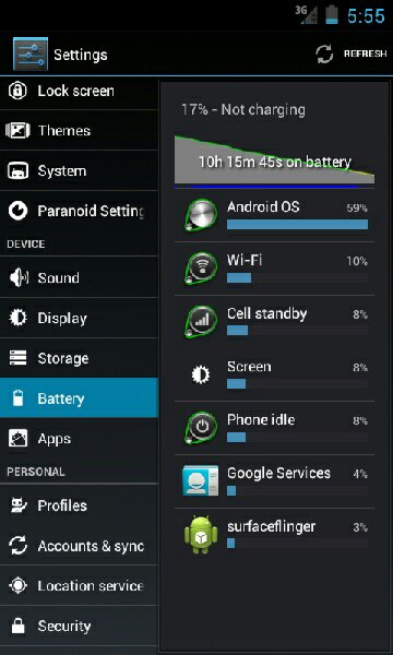

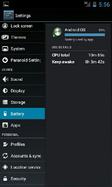

I havent been on this forum in a long time as I have moved on to the Nexus 4 running PA 3.69. My wife is still using her triumph. I previously ran cm7 on it. it ws getting sluggish so i cam back to see if there were any updates to that rom. It appears that development has stopped on that and you guys have moved on to PA. Awsome! PA is the future. you should see what they are doing with the nexus line of phones.
Anyway, i installed this rom (july 31 build) and her phone is gettting a wake lock of DEATH. android os will not sleep. after a few hours this morning her battery was dead. battery stats show that android OS has been awake for 7+ hours. any idea what might be causing this? Im about to factory reset and re flash the rom to see if that helps. any suggestions are welcomed

Here if a screen shot of her

So I had her run her phone all day with Wi-Fi off. She has Wi-Fi at home and work. The phone went into deep sleep. Something with the kernel or ROM is preventing the phone to sleep when Wi-Fi is enabled. Any suggestions? I've tested this on 2 triumphs each with multiple factory resets.
I'm
fairly sure that the lack of deep sleep in Wi-Fi is a known issue on this ROM. Correct me gentleman, if I'm mistaken.

Our kernels have an intentional wakelock to prevent a known sleep of death issue caused by the processor going to sleep with the WiFi radio on. This traces back to about two years now.. My how time has gone by.
