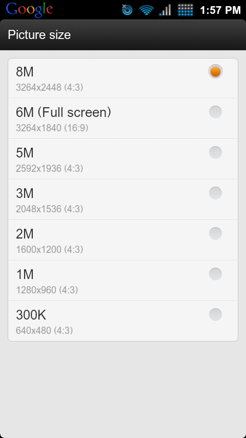

the theme doesnt, but the carrier text google does

oh well, nice clean slate is always refreshing/me likey that notification bar.
Does it come by default with this rom?
Yeah that's not the stock theme, but the google can be removed or added depending on the theme, some are more customizable than others. If you have ANY app, say weather bug ect. that constantly displays temp or whatnot it gets overridden anyway, google/carrier text that is. You only see it when you pull down the notification bar.
If you like blue and honeycomb try the SJ_Honeycomb theme, I love it and it has many different options to alter the theme.
