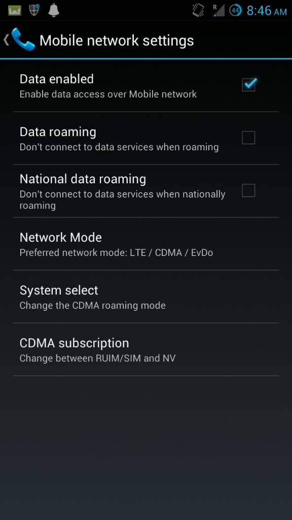

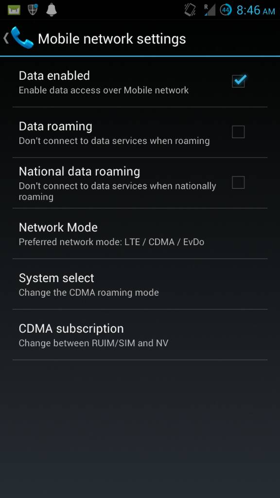

Check under networks that you have RUIM/sim selected and you have LTE/cdma/evdo as the network. That was my issue.... AOKP set my sim to NV and narsed everything up.
On a related note, anyone know why I have roaming turned off, but see this signal icon?
I'm guessing it means I'm in 1x, since I can access this forum, but I wanted to bring it to everyone's attention.
Lol the irony. You're telling a guy how to fix roaming while you're roaming.lol. that r means you're roaming mrB.
