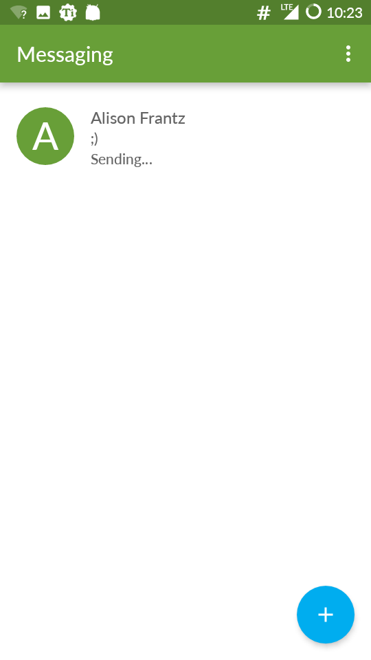

Still having issues with WiFi but I dirty flashed, anyone else do so & still have issues?
Dirty flashing seems to maintain the previous WiFi state. I'd recommend backing up your apps and running through a clean install.  If you still have issues after that I'll need dmesg and logcat taken shortly after a WiFi issue.
