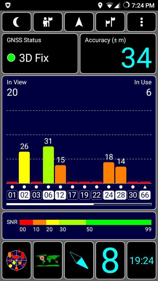

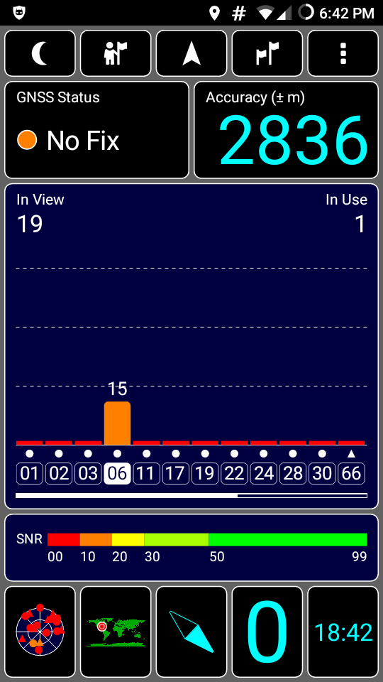

I found a pretty solid gps enhancing solution while I'm waiting on my copper tape to ship. All it takes is some handy dandy aluminum foil. Here's a picture of what I did. My satellite connections have gone way higher than ever before. Earlier today I had about 6 or 7 excellent satellite connections. There's a huge difference in quality of gps. Check out the pictures.

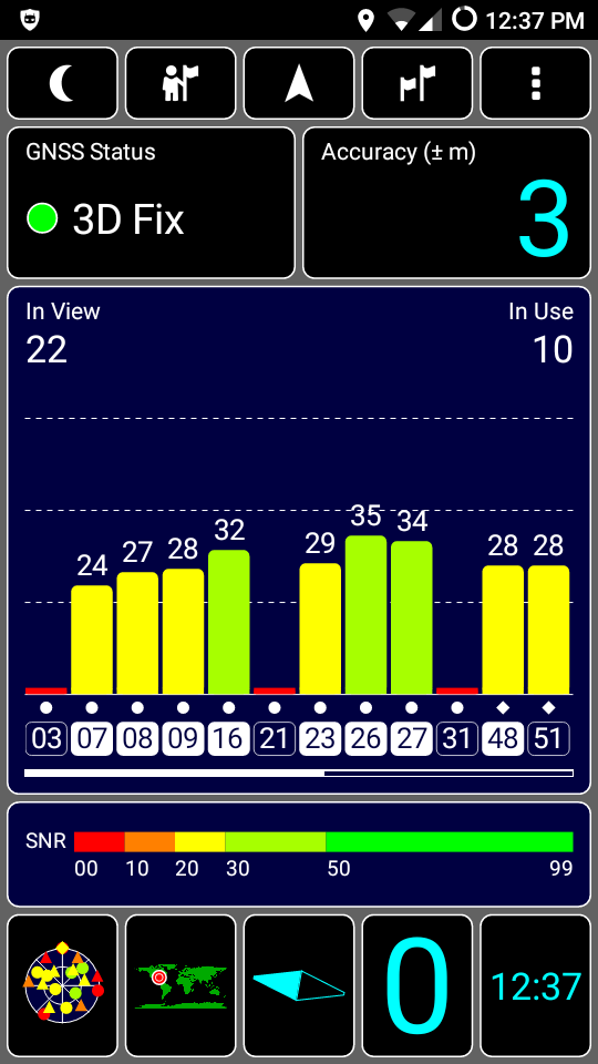

See the attached picture. Signals from the GPS Test application and that's only showing 3/4 of the signals I was getting. The accuracy is amazing. These are the kinds of signals I'm getting outdoors and in the car should be similar because of all the windows. The pictures in the post above were taken from inside my house. Now that I've got the reception part figured out it should prevent the gps from losing its signal and acting so wonky. Now I just may need to tweak the gps.conf file some more, but I may not need to do that at all. I'll let everyone know how my test drives go. We just may get the Volt's GPS working after all. I nearly gave up on it, but since I have a ton of free time I decided to keep working on it. I'm curious to know if anyone has ever had as good of signals with their Volt before.....
YESS!!! Guys, it's working perfectly with the latest release of Lineage. Test drive number 1 - Maps gave perfect turn-by-turn directions, perfect rerouting, and perfect audio. I never lost my signals whereas before the signal would come in and out every so often. The aluminum foil really acts as an antenna booster and pulls in excellent signals...even better than my Samsung Galaxy. Spock1104 - I apologize for all the posts, but I finally struck gold. Not trying to take over your ROM thread, but I wanted to share this info because it genuinely works. Attached is the GPS.conf file I settled on. Rename the file to "gps.conf" and place it in your "/etc/" folder with "rw-r-r" permissions. Alternatively, delete everything in your gps.conf file and paste the entries below to "/etc/gps.conf" - Combine it with the aluminum foil fix I posted yesterday and your GPS will be good to go. Sometimes you have to move the aluminum foil around a little above the camera lens to get the signal increases. Use GPS Test to check your signals and when you see signals low to high 30's you'll know it's effective and needs no further adjusting.
