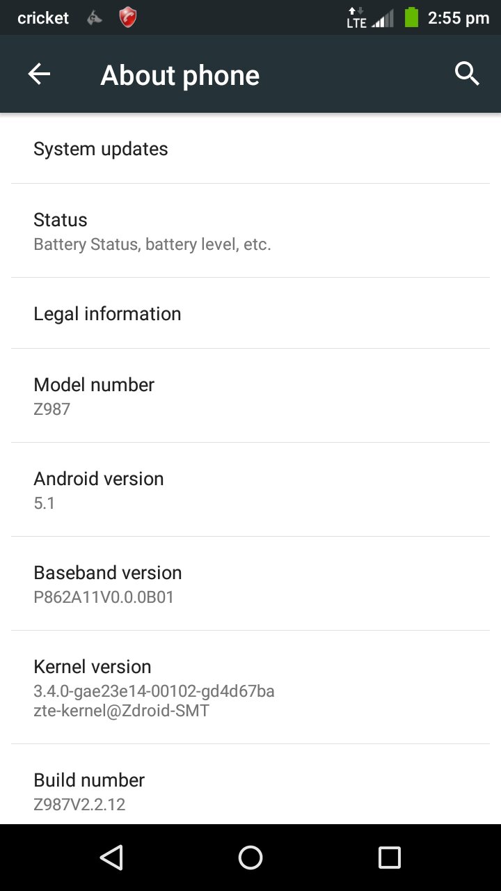

Sorry, fell asleep
I'm making a new 5.1 update zip now that is pre rooted with SuperSU. I also added some lines into the script that let you know what is going on while the ROM is being installed along with a progress bar to gradually fill while the ROM is being installed. This way you know its working and it isn't just stuck. I need someone to test it.
