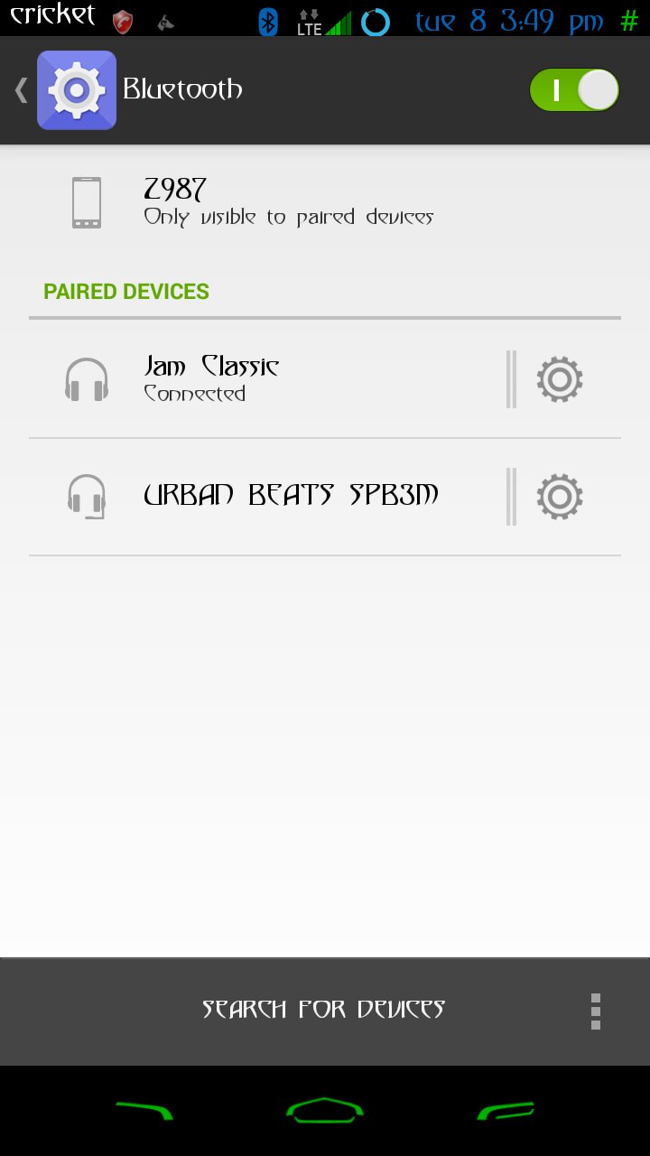

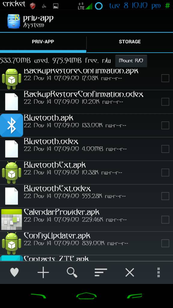

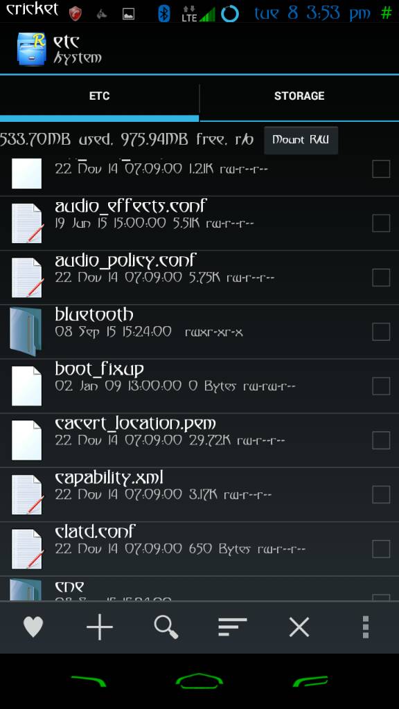

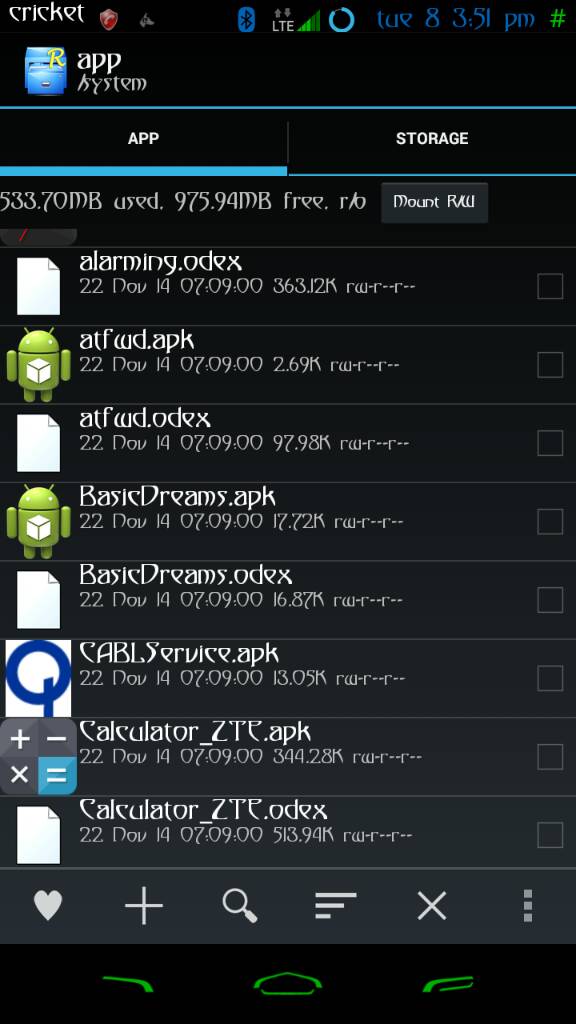

Ok I am 4.4.4 and connected to Bluetooth. These screenshots show all Bluetooth related files I could find. If you know of any other place to look, please let me know. I will stay in time warp for a while, haha

Interesting! The files that I am SURE that I need are libbluetooth_jni.so and the exact same file, apparently, in a different location. I wonder if you have two copies and/or versions of the same file.

Ok I have checked manually through all folders in the system folder. You have all the files, the last of which I just sent you. They now need to be put in the proper folders to test. Let us know how it works out. If you need help where they go, I am still in 4.4.4
Yes, please tell me where they are supposed to go. My first stab was a failure.... I matched the 5.0 locations.
The two apks and odex files belong in priv-app folder. The bluetooth folder from the zip I sent belongs in etc folder. And the .so file belongs in the lib folder.
You also have to figure out which lib files go to which apk and symlink them properly in addition to having the correct permissions set for every file and folder. Lollipop is a lot more complex than KitKat. One mistake and you can cause more problems. Take the aosp keyboard for example. The apk is /system/app/LatinIME/LatinIME.apk
Then you have to put libjni_latinime.so and libjni_latinimegoogle.so inside /system/lib and set the permissions to rw-r--r--
Then you have to create symlinks for both libs that point to /system/app/LatinIME/lib/arm
Because of this you have to know exactly which lib files each apk relies on or else it won't work.
If you don't know how to decompile an apk and figure out which lib files each apk requires in order to run this can be like searching for a needle in a haystack. I hope you have a lot of spare time on your hands.

It pairs, but when I got to make a phone call, only the very next phone call seems to work properly unless I unpair and re-pair.
No idea why, but bluetooth seems to be working again with the stock lollipop rom. Keeping my fingers crossed.

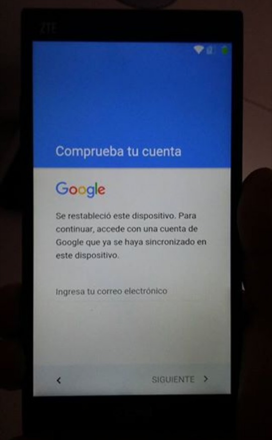

someone already has a different rom? I bought the phone on ebay , when I wanted to restart the factory asked me forma a google account and do not let me go to that screen, I have this phone unusable :( Who can help?
I'm from mexico and here there is nobody who can help me because this phone is not sold here, Iwant my phone!!
there is a different rom the stock ???
please someone help, sorry for my English but I use google translator, I hope your help, masters
"This device is restored to continue enter a Google account already you have been synchronized in this device"
In spanish
