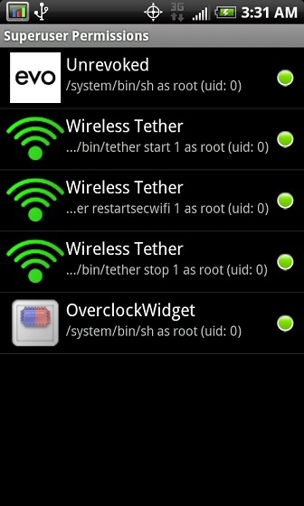

It def asked me for SU permissions, and it shows up in the app as well. here:

I take back everything I said now. I found out I was having issues with my superuser permissions and I believe now the program was not in fact working. However, I do now have something to base it against. I will test again tonight and report back.
