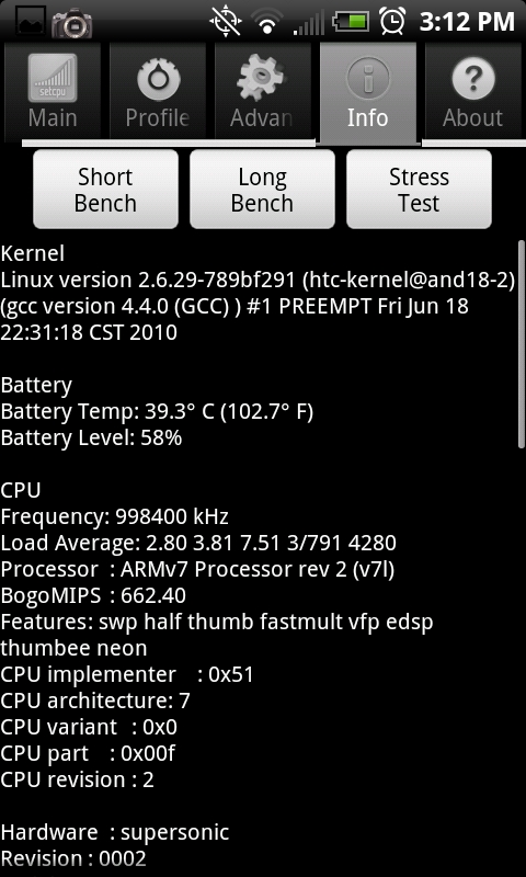

Here are my screen shots:
Yea after I uninstalled setcpu the first time it went back to being snappy.
One problem I see is that my max only goes up to 998
The stock kernel has a 998 MHz max, that's not the problem. The only thing I can find off with your screenshots is that apply on boot on the main tab is not checked. Also my up threshold on the advanced tab is set to 70, and I don't remember ever changing it from the default. Also, I assume that you've been hitting menu -> perflock disabler on every boot up. If your still getting lag then I have no more explanations
