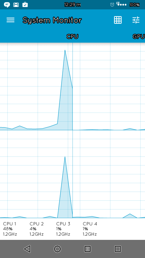

My first error was access denied.. Idk I gave it rw-r-r, so I guess time will tell..
idlieing at 200mhz on c1-4, 3-4 are not taking any load. Spike when I took screenie.
Side note, from 100%-26% battery life over 6 hours of constant use... No sleep time, streaming Pandora over a WiFi, thru a BT system.
6hours - 74% used.
I'll report back on the difference
6hours - 74% used.
That's slightly above average battery life, but not very demanding processes.
