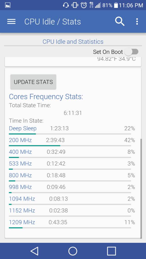

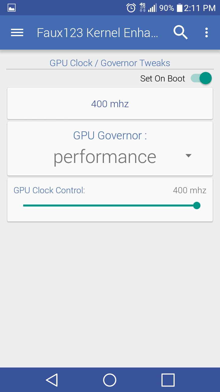

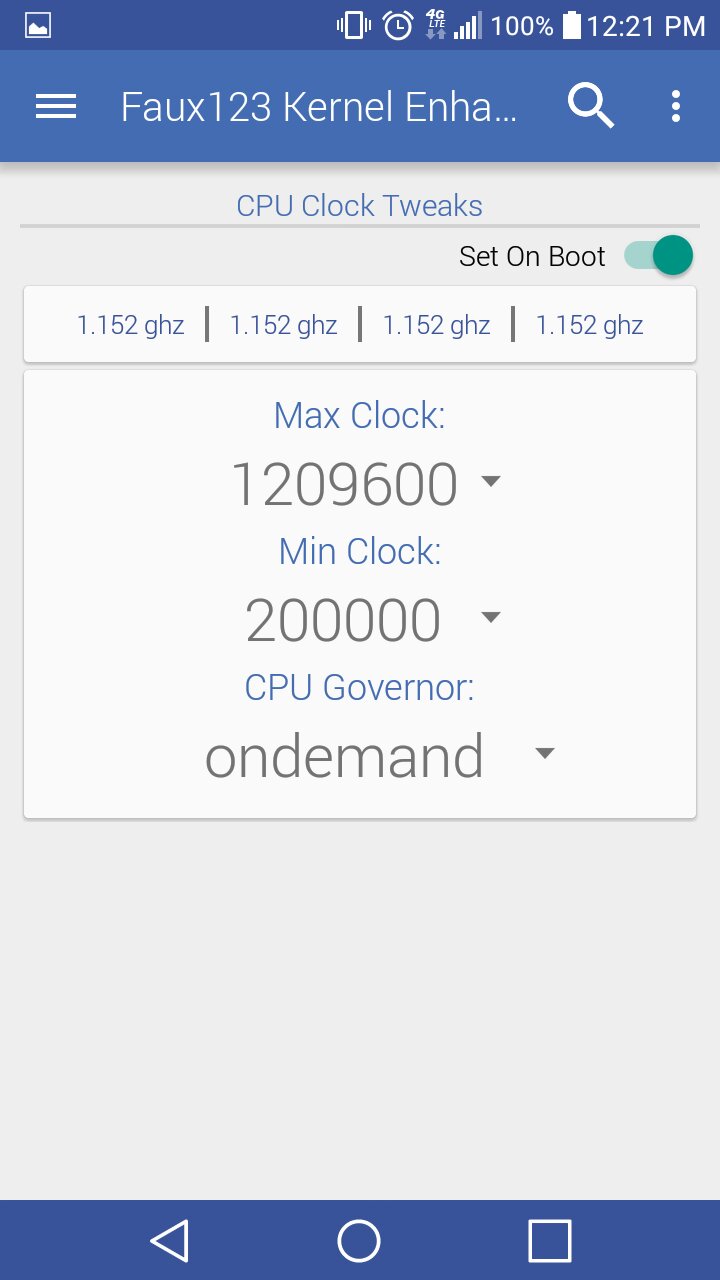

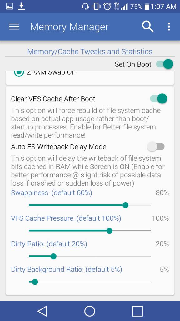

I use FauxClock. And it works good with out the. That script. Not saying that does not work just that its other ways too. Here are screenshots Now. I which we had a kernel with inteliplug n sdio scheduler thermaplug n supercharge. It woul b awesome...
