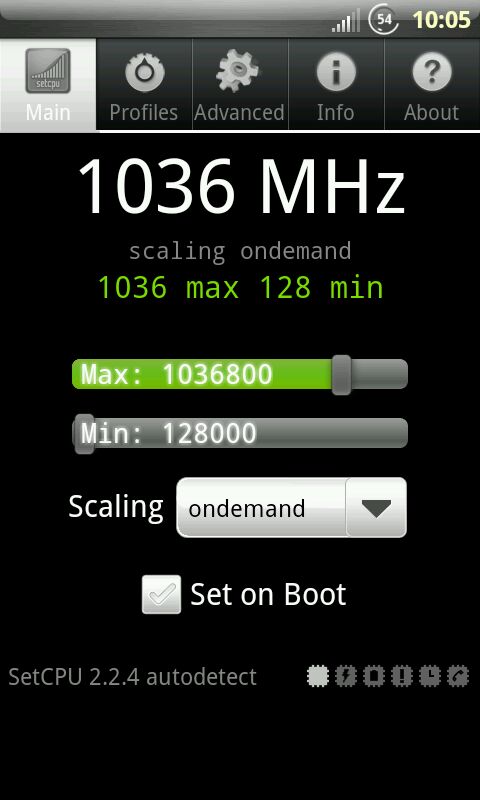

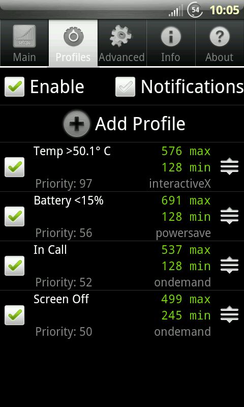

So I just started playing around with setCPU, and I thought the best way to make sure I don't blow my phone up is to ask for some opinions.
Vitals :

IMO i think that u have too many profiles. i would only have a screen off profile and use the ondemand governor. too many profiles is counterproductive if your goal is to save battery life. but if you are getting good results then i would say keep it. but for me too many profiles with setcpu and my battery life sucked.
Thanks ocn - I guess I'll run this for a few days and if I experience bad batt I'll drop some profiles.
One thing I'm wondering - I listen to music @ my desk at work alot using doubletwist...I've had a couple of problems where in the middle of listening to music, the phone just starts bootlooping. Does that have something to do with my screen off profile being set wrong?
Thanks!
-HN
judging from your profiles, i do not see a reason that they were the cause of a bootloop. however, you might want to try and bump up the min's on your profiles. you might get some lag and issues when receiving incoming calls otherwise. try and see if that makes any difference.

As Ocn stated, your settings are counter productive on your profiles to your scaling settings....change that and you will be amazed with the difference.....after that charge phone to full charge, unplug, plug back in to make sure its full charge then reboot to recovery and reset your battery stats, or install an app that allows you to reset stats without rebooting like "BatteryCalibration". Hope this helps ya
I only use a screen off profile. I agree w/ Ocn in saying that too many profiles does more harm than good. When you have too many profiles set your phone is constantly checking if conditions are met to use those profiles in turn eating up more battery.

One thing i noticed from running setcpu on my phone is that if i set it to 128 for the min it makes my phone lag and it gives it some lag when u turn the screen on. i have it set to 245min and 1152 max running on demand and sometimes smartass (as smartass governor has a screen off profile which also make my phone lag) and it runs pretty smooth, my battery life varies with phone use, it can be as good as a day and a half and as short as 12-15 hrs.

I would highly recommend no profiles and use the interactiveX governor. I have yet to run a rom without having great battery life and without having significant lag with this governor.
And if you're running AOSP rom's with the latest kernels, the SmartassV2 governor is essentially the same as interactiveX;)

One thing - when I play certain apps, especially Angry Birds, my phone tends to heat up quite a bit. Don't know why. Anyone else having that? That's why I set up that temp profile.

More than likely, playing AB will heat up any phone. So there's probably not much you can do for that except maybe not play it for long periods of time.
