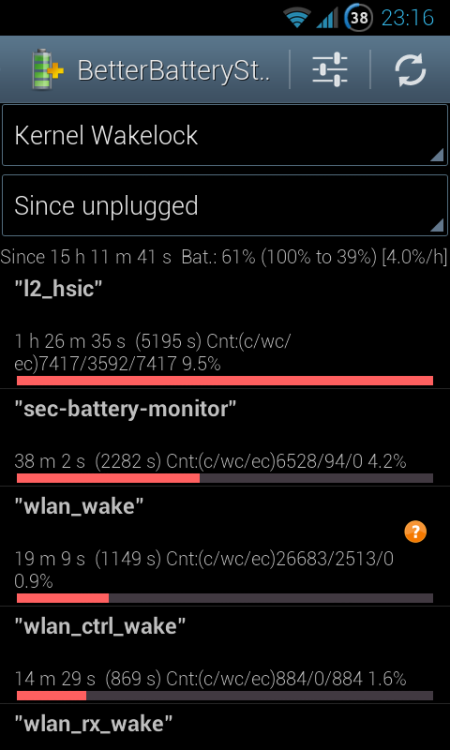

My battery has been taking kind of a hit lately. The phone was off the charger for 15 hours, with the wifi on for about half of the time and is down to about 40%. Deep sleep is only running about 74% of the time but I have a couple of bigger kernel wakelocks and was wondering if you guy could give me some advice.
Thanks

That sounds like a battery calibration problem rather than anything more sinister. 60% battery depletion in five minutes has to be a false reading.

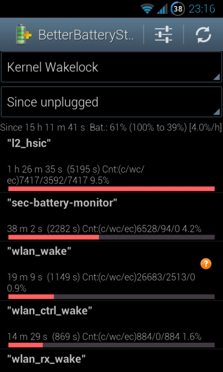

Thanks
l2_hsic is the wakelock commonly found with unmatching RIL, I think. Are yours matching?
Can't help any further, sorry!
