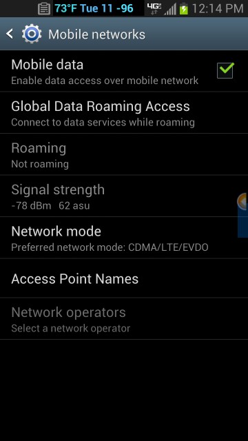

It's your Mobile Networks settings screen that looks strange.
Here's mine:
