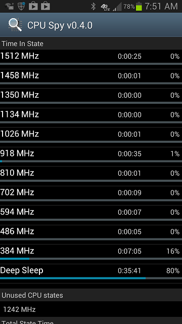

Can i suggest the app "cpu spy"...
It wont tell you whats doin it but if you reset timers in cpu spy, turn your screen off and leave it say 10mins, turn on, open cpu spy, and restore timers.... if "deep sleep" isnt the biggest thing, you have a bad app.

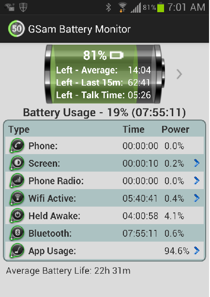

Here's a screen capture from aLogcat.
aLogcat is too clever for me but i use Gsam.
What were u doin with the phone during the time the Gsam stats were taken bro?

Nothing. Wanted to give it A clean reading.

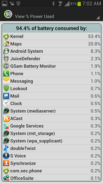

So I changed it again yesterdan and unplugged before I went to bed. It was at about 80% this morning, so Google Now didn't seem to have a big influence. I then installed CPUSpy and let it sleep while I drove to work. Attached are the related screen shots. Maps still seems very high, considering I didn't open it at all. Other than that does anything look out of the ordinary?

Here's what I got:

What shows in the details if you click on Maps in GSam? Maps is notorious for sucking large amounts of battery even when you aren't using it. Try disabling Maps temporarily.
What was the Total State Time on your CPU Spy stats? That stat is cut off at the bottom of your screenshot. The other CPU Spy stats show the phone in Deep Sleep most of the time, which is good.
But the GSam stats show the phone being held awake 4 hours out of the 8 hours, which is bad. Apparently the GSam stats were taken before the CPU Spy app was even started.
The GSam stats show high usage by the Kernel, which is bad. We need more info on the Kernel stats. If you click on the Kernel item in GSam stats what system processes are at the top of the detail list?
