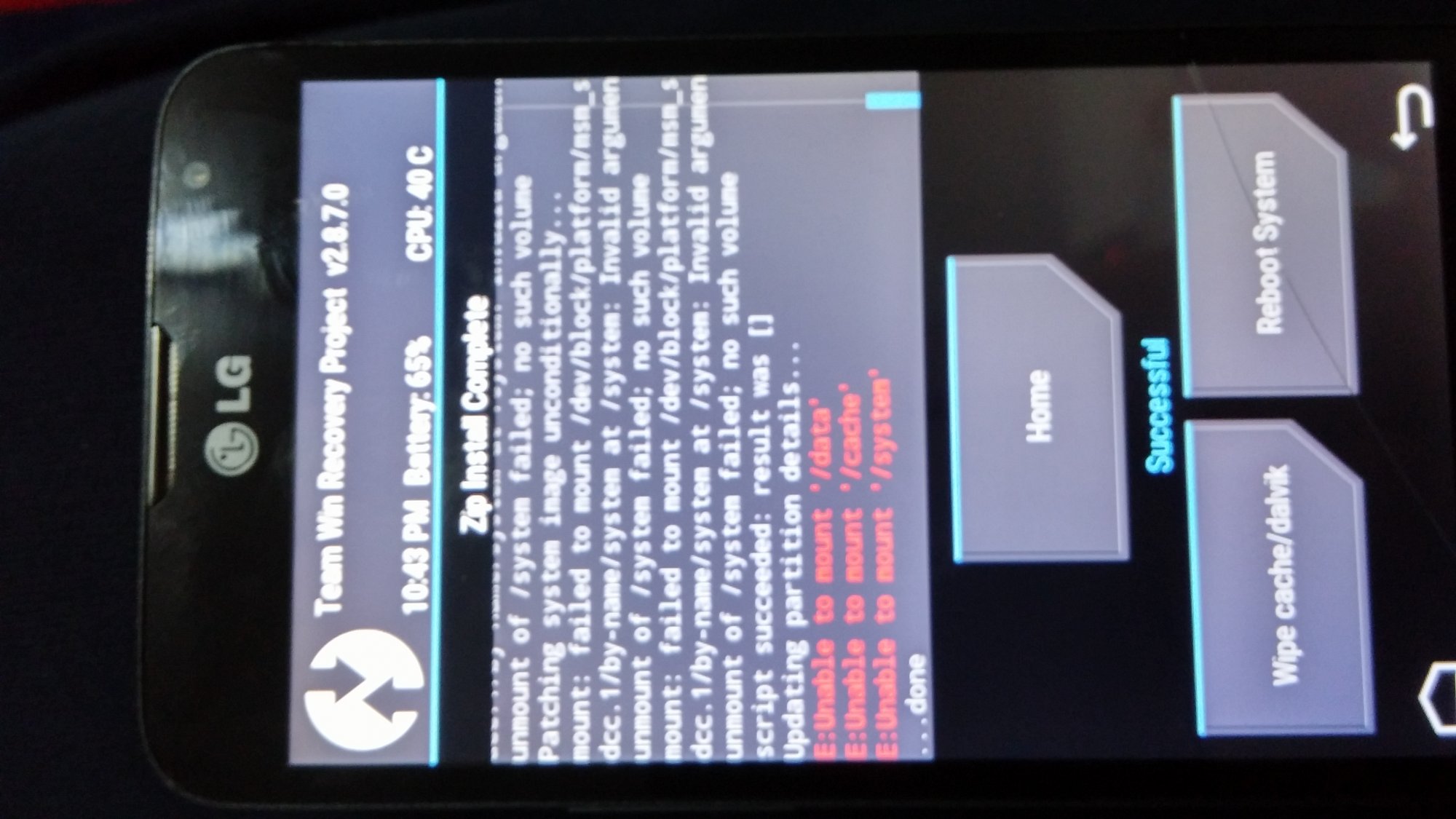

Can anyone explain this to me? I'm about to get my hands on an L70 D325(a friend's request) and I told him there's a stable cm 12.1 for this device. I've flashed custom roms before but i've never had to pay attention to the bootloader(after the unlock process is complete). I just need an explanation what's this all about. I'm familiar with the rest - rooting, unlocking, flashing recovery, flashing rom/gapps, etc. .For correct working RIL (Sim detection) and keys you need correct (for you variant of L70) bootloader (aboot.bin).
https://www.youtube.com/channel/UCMV_0UVLvV930IPPg9ets-g/videos just follow this group of videos from first to last and you will be good. Answer to your question is that you need to flash aboot.bin for your phone so you dont get errors when you try custom recovery etc, its in guide also, follow vids and good luck.Can anyone explain this to me? I'm about to get my hands on an L70 D325(a friend's request) and I told him there's a stable cm 12.1 for this device. I've flashed custom roms before but i've never had to pay attention to the bootloader(after the unlock process is complete). I just need an explanation what's this all about. I'm familiar with the rest - rooting, unlocking, flashing recovery, flashing rom/gapps, etc. .
I've had a good look at these videos and they're indeed helpful. Thank you for those.https://www.youtube.com/channel/UCMV_0UVLvV930IPPg9ets-g/videos just follow this group of videos from first to last and you will be good. Answer to your question is that you need to flash aboot.bin for your phone so you dont get errors when you try custom recovery etc, its in guide also, follow vids and good luck.
These are not dumb questions,this is what these forums are forI've had a good look at these videos and they're indeed helpful. Thank you for those.
I understood the part about needing to flash the proper aboot for the device(in this case D325), but what I'm not sure about is when I must flash it. I found a thread where a user has posted stock aboot for D325. So... I guess I'll have to boot into twrp and flash that aboot.zip before flashing any rom, right?
Sorry about these rediculously dumb questions, but as I said, I've never had to flash the actual bootloader before, just unlock it. ^^
aboot.bin flashes through fastboot (cmd on pc) here is the link http://androidforums.com/threads/dump-all-variants-aboot-files-and-how-to-flash.918174/. get your aboot.bin from here and follow provided guide to flash it. aboot.bin flashes after installing twrp, because you will be unavalible to use it without flashing aboot.bin, you will get purple screen. so in this order :That's all the info I needed. I'll probably share my results with my friend's D325 in a few days. Thank you and God bless ya!If you need any more questions feel free to ask. Cheers
No need to repartition, just install like any other romThat's all the info I needed. I'll probably share my results with my friend's D325 in a few days. Thank you and God bless ya!
I forgot to ask, since the device is currently running 4.4.2 KK, will it need repartitioning before I attempt to flash CM 12.1?

I have d325f .. I have cwm recovery is it okay .. I have not installed rom .. how to know whether I have correct aboot.img or not .. I'm new to these things .. please help .. what are the things still not working ..??
sorry for this stupid small questions ..
These are not dumb questions,this is what these forums are foraboot.bin flashes through fastboot (cmd on pc) here is the link http://androidforums.com/threads/dump-all-variants-aboot-files-and-how-to-flash.918174/...and follow provided guide to flash it. aboot.bin flashes after installing twrp, because you will be unavalible to use it without flashing aboot.bin, you will get purple screen. so in this order :
-follow videos 1,2,3,4 until u succefuly flash twrp
-follow video on how to flash aboot.bin
-install custom rom
