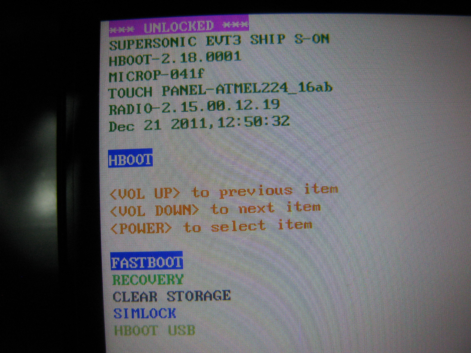

Iv'e tried just about everything on this forum and i still get the same problem ive reset my evo to factory settings it ive tried it in disk drive mode instead of charge only Iv'e installed unrevoked forever on my root but im not sure if i flashed it, recovery in hboot just reboots my phone and my ship s-on still maybe im not flashing it right i dont know i get the same error from unrevoked 3.32 " firmware too new" help please
it says Suoersonic EVT2-3 Ship S-on
Microp-041f
Touchpanel-Atmelc03_16ac
Radio-2.15.00.12.19
Dec 21 2011,12:50:32
oh and at the very top it says *** Locked (oow) *** highlighted in pink
Microp-041f
Radio-2.15.00.12.19
So it looks like you have the latest software version (4.67.651.3), which is Gingerbread 2.3.5, and your firmware is in fact "too new" to use unrEVOked. You'll have to follow this guide to unlock your bootloader and gain root access: http://androidforums.com/evo-4g-all-things-root/488901-rooting-gingerbread-2-3-5-dummies-guide.html

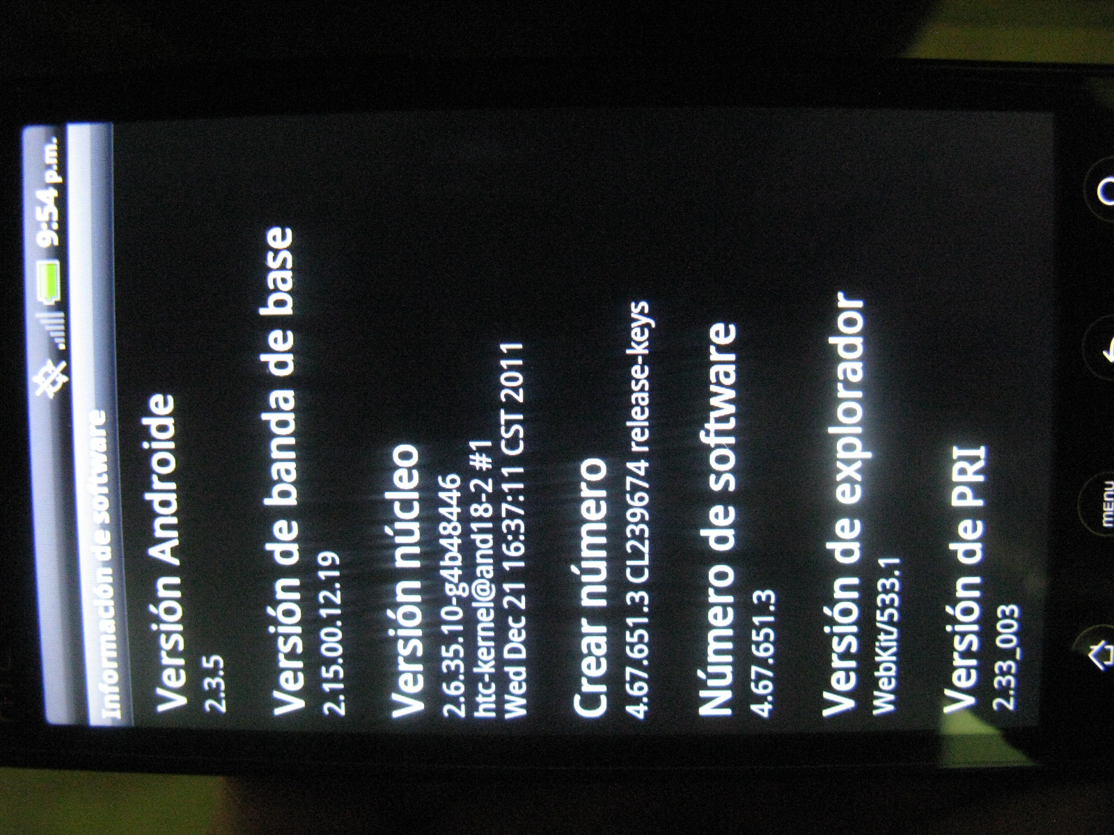

Every thing was good to go coming out from out [Revised] Rooting Gingerbread 2.3.5 Dummies Guide every thing was working with mik rom. Everything was running smoothly up to step 10. Once it ran and did the update. I then tried to unrevoked3 I get error:failed to get root. Is your firmware too new? I also cant get the recovery screen to load fully. It open up to a red phone and freezes there. Once I boot my phone back up it was back to the way it was when I first got my phone. I use check root and I'm not rooted and Superuser is not installed. Can someone please help guide me back on track
welcome to the forums!!!!!!!!!!!!
ok looks like you are using the captain's method to get fully rooted. out of curiosity does your phone look like what is posted in step 11? just to be sure what is your hboot now? and also what is your radio?
and you will not be able to get to recovery as the PC36IMG file is called a ruu (rom utility updater) and it will install the stock rom and recovery for whatever software version. so you are getting the red triangle with an exclamation mark which means that you do not have access to the stock recovery. this is normal.
