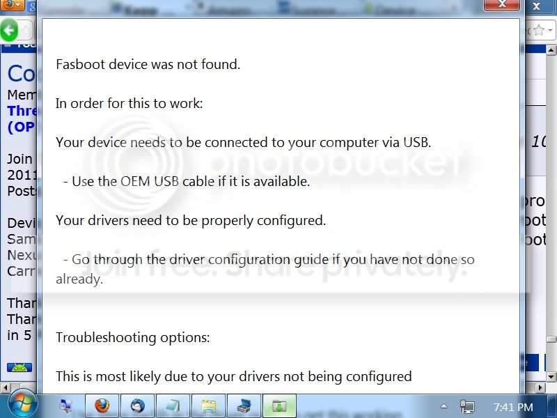

.That's why I asked u eairler if I had all the files I needed, and which toolkit are u talking about? We have talked about two different kinds here.Upon further review of the tread, it looks like you you didn't try to install jellybean, only the kernel which is only a part of the whole package. The easiest solution to me is to factory restore you using the jellybean factory image provided by the toolkit. Based on the earlier picture, it appears as though the fastboot drivers are not installed.
1) Use the toolkit to install the samsung usb drivers. Once they are installed, boot the device into fastboot mode by pressing both volume keys and the power key while off and then plug it into the computer. The toolkit should have instructions for installing the fastboot drivers, but to do so, open up the device manager and you should see the nexus listed under unknown devices. You will right click the driver and click update driver software. Choose the option to install from location. it should provide you with a list of drivers, you want something with ADB Android Development Bridge in the name.
2)Once that is set up, on the main menu of the toolkit, check device bootlooped, and click that restore factory/unroot. Select the 4.1.1 verizon(toro) image file and it should proceed. It should work by itself and should take about 15 minutes.
