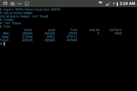

Multiple apps. Rom toolbox which had some issues prior but more frequent now, of course they just released major update today and there are issues. com.android.vending of course and yes I did clear cache, no help. And others. Was trying to send you,lv, a screenshot o
swap in TE and get a not found response
You have swap running. It shows with the

he problem with the first command is you don't type the whole word processes. Try
Code:
cat /proc/swaps
You also have SSM set up properly, as it shows a listing for /data/app and /data/dalvik. I'm not sure what could be causing your fc issues.

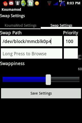

This is what I use with SSm
