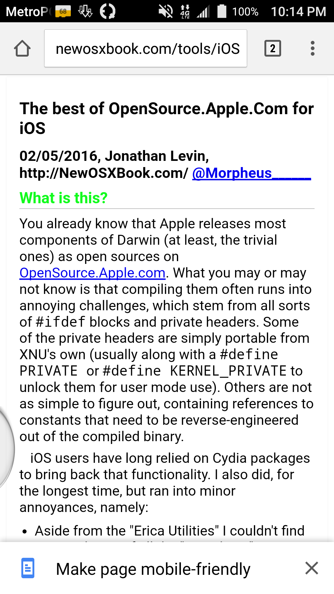

It's iOS but runs on linúx? Also I think can set up different environments******edit**** also ROP Gadget Tool?

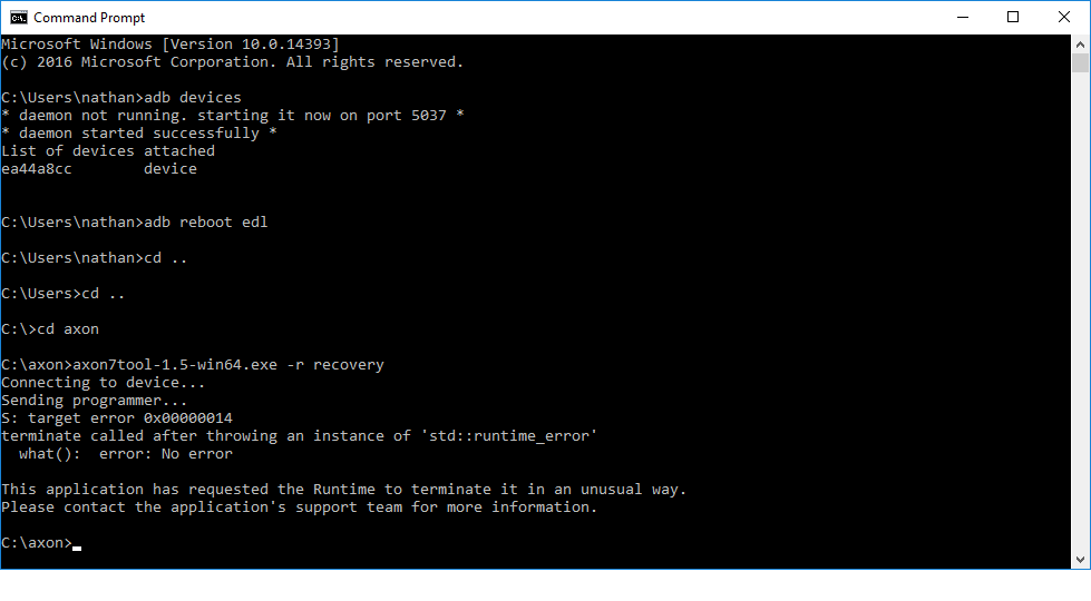

I deleted the drivers for all of the other phones I have and PDAnet because I thought they might conflict. It did the same thing.
I tried it with different drivers instead of zadig, and got a little bit further. I didn't think my phone was going to come back on afterwards. Anyone know which version of Linux it was built on?
