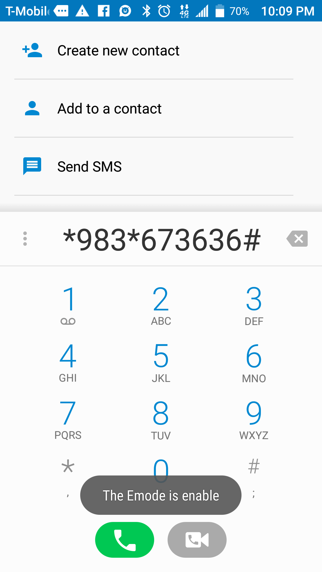

engineer mode ? do you mean factory mode like the one on samsung devices ?
Not sure.. I just remembered that it was achieved after one of our guys gave us a dialer code.. testers reported back it said engineer mode enabled on the toast..

Enter "Engineering Mode", by dialling *ZTE*OPENEM# (*983*673636#) -- this action will be confirmed by a quick pop-up. To close this mode, dial *ZTE*CLOSEEM# (*983*2567336#) -- this then prompts whether you want to do a Factory Reset, which you do not have to do (you can simply Back away from this screen).
I had a little message pop up that said the emode enabled I think, and then a bigger one popped up and said process cancelled. It disappeared really fast.

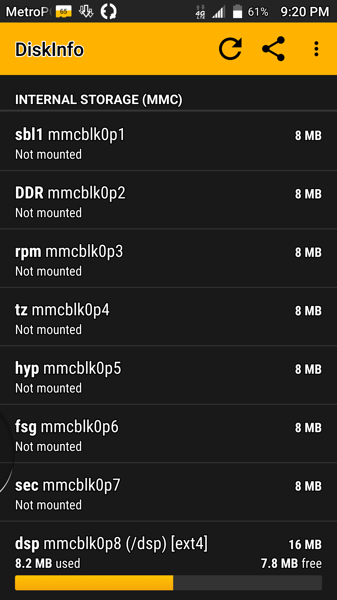

Anyone needing partition info there's an app called Disk info on Playstore. It's pretty detailed
I forgot about that. I am on b08 which my phone came with. When I typed the code in it just said emode enabled, so it must be working for me.

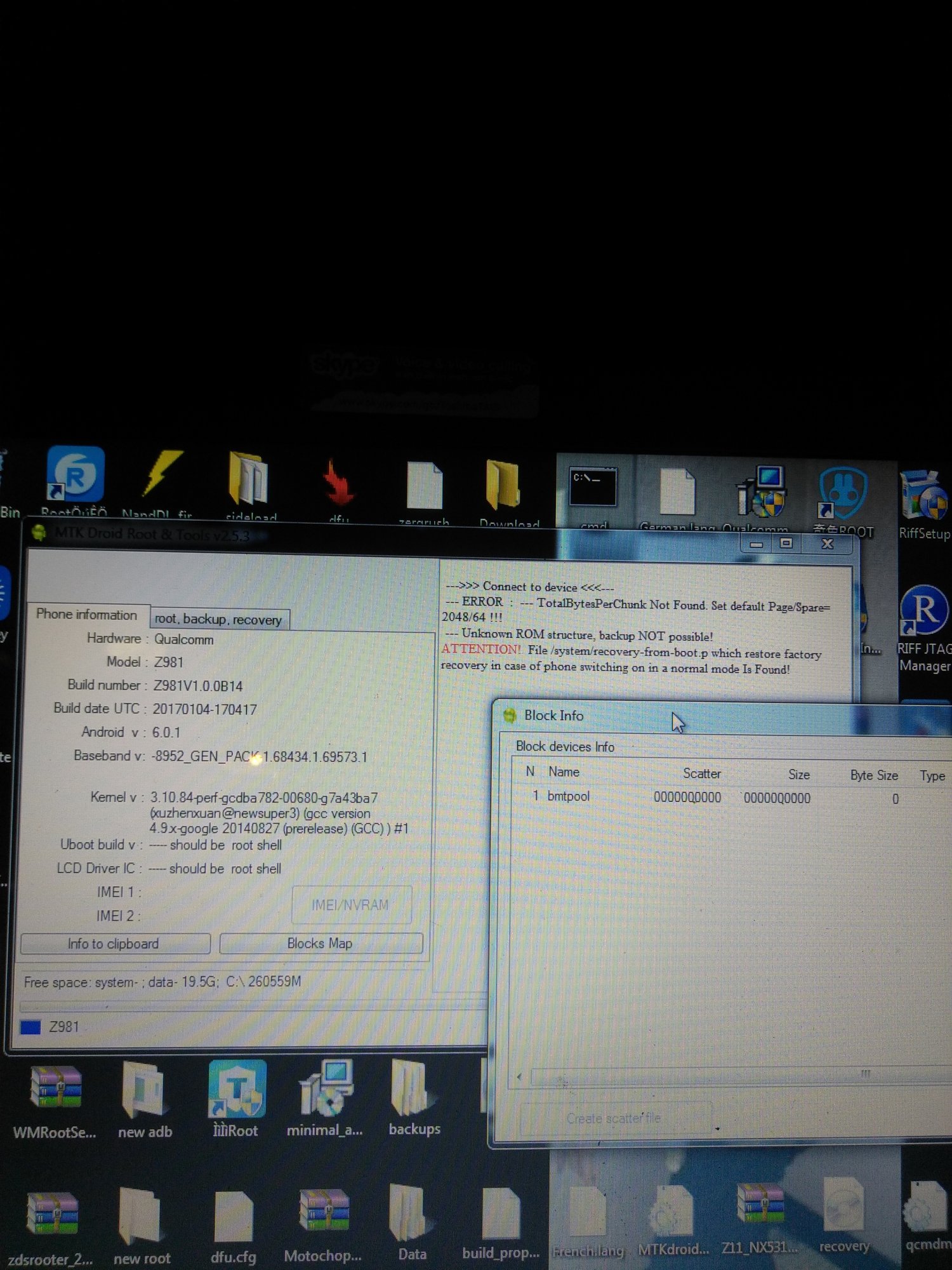

Qfil Quaalcom Flash Image Loader which is part of QPST can flash TWRP. It's interesting. Now I'm looking for a device like ours that it has been done on. It still may be option.
it wont let me create Scatter file.. to flash twrp... This phone ita completely block to read the f*#** system OMG... can create nothing, can flash nothing ? Whats going on in here
