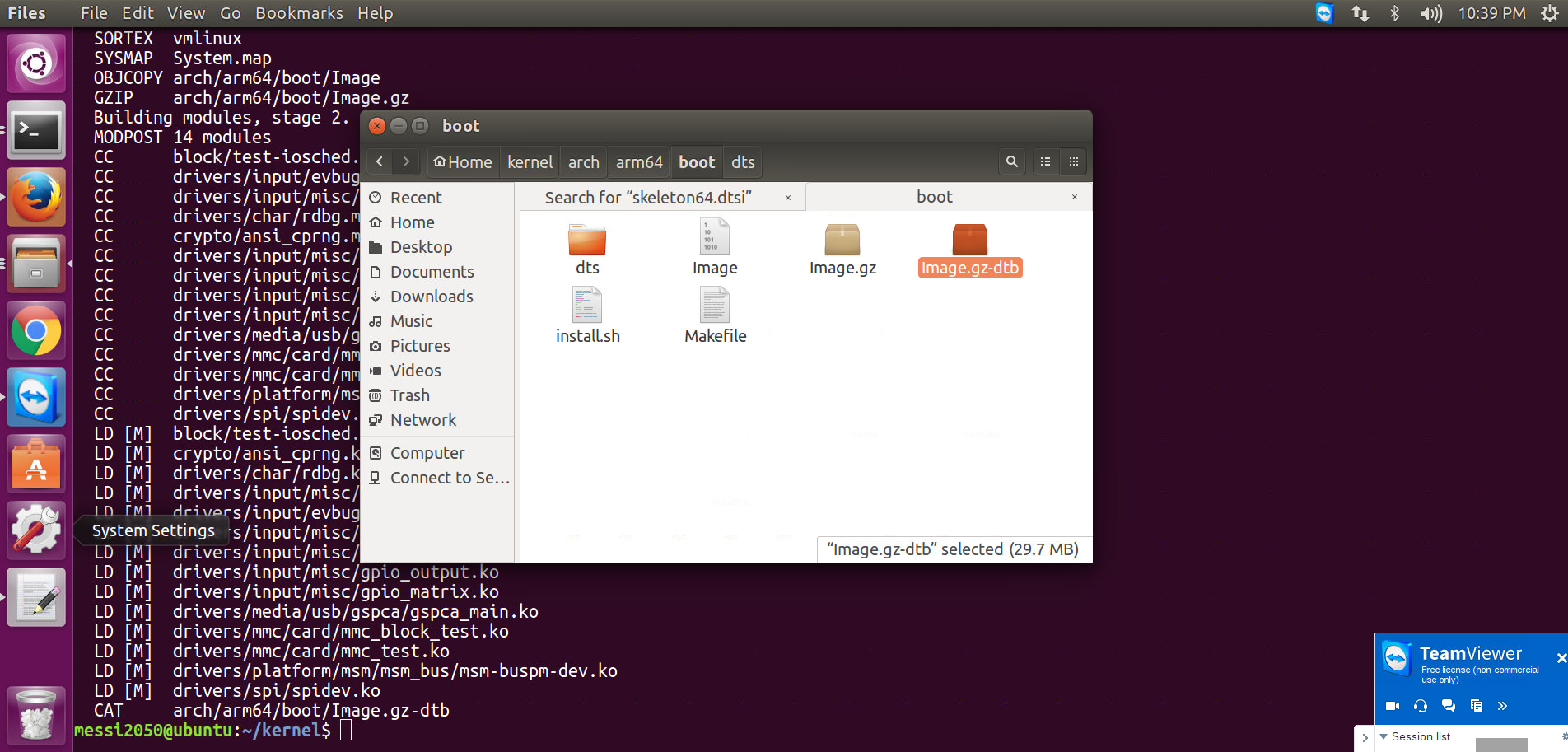

finally got this crap to compile successfully :D
