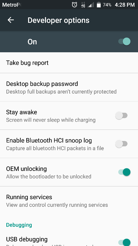

Do you have OEM unlocking turned on in developer options?
yes i did thats the first thing i do when i get an android phone ive flashed imgs like this i had a samsung galaxy core and i flashed the twrp img of the galaxy core duo and it orked so this should work as long as the chipset is similar
