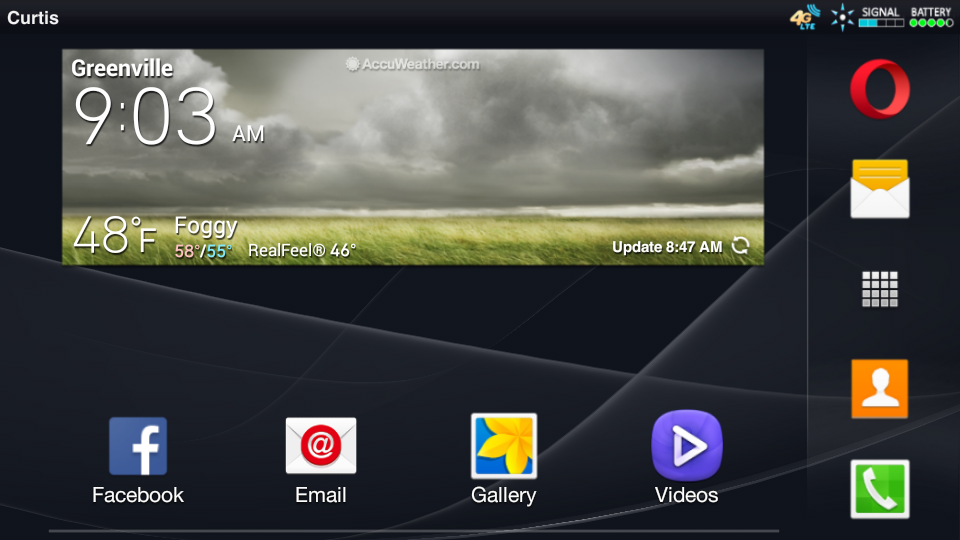

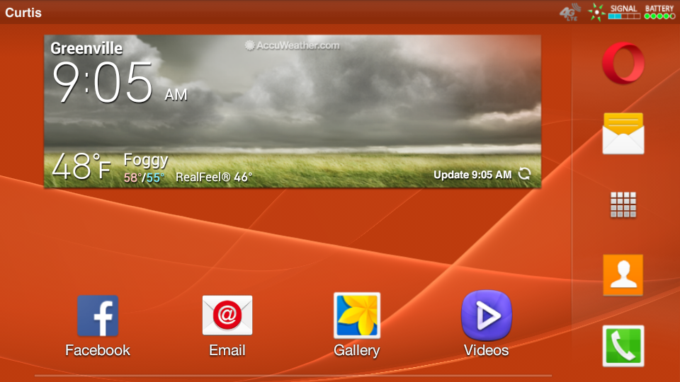

I will be posting an updated set of SystemUI apks for both devices in a few days. They both give the semi transparent status bar on homescreen like sense based devices have. I am hoping to replace the current xperia launcher with another set..just need to debug it from its original port...which is causing issues on our stock setups. I am hoping to change our entire ui to a more flat material scheme. But with a twist and for the fact im doing it alone which is time consuming...I will use the current coloring you see in all the apps. They will just be flatened out.

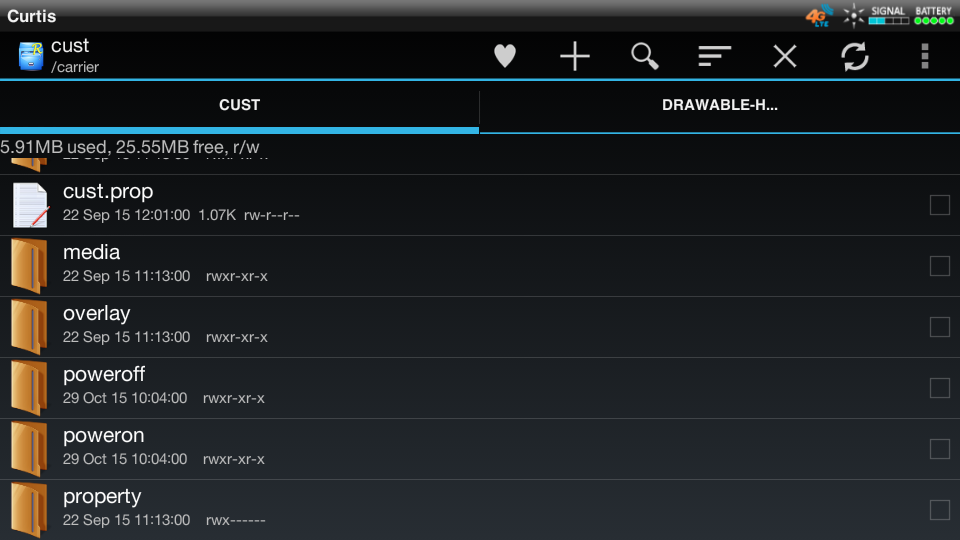

I looked in system/media and only found your boot animation zip,and in audio a 0mb sound file for boost and sound files for sprint and Virgin. Where else would I look for bootup.
look in root/carrier/cust... two folders,poweroff and poweron. just copy the two i have in system/media over to their respective carrier folder.
going to try to post a set of vrthemes to apply to framework,lge-res and SystemUI later today. fixes for framework dialog prompts and these updates with glass status bar on home along with colorized sprint spark lte spinners and the lte data icons...need to test the vrthemes first to be sure they dont break your apks first...
