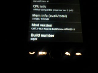

Look what I fixed! Anybody want to take a wild guess at what it is? :D
how can we can the alarm clock to go off on cm6 adn cm7? mine wont go off unless i open the screen
for CM7 i had 2 launchers on my phone (came w/CM7, & paid version). in sleep mode the clock lag to the right time, so i deleted the launcher that was provided to CM7. now my alarm clock works well. not to say that is the problem, but it worked for me...
how did u manage to get it to work? that was one the reason i went to PG's 0727 build.
Its missing a file. I was messing around looking in the zip files of some builds. And I was in CM6, which the lights work in, and noticed in the system>lib>hw there was 2 files that had lights in the name lights.msm7k.so and lights.glacier.so but CM7 only has one of them which is lights.msm7k.so So I extracted the CM7 zip file and deleted the lights.msm7k.so file and copied the 2 lights. files from CM6 and stuck them in CM7 then threw everything back in a zip file, and flashed it and now they work. I dont know if theres anyway to access the system>lib>hw files in root explorer or anything I did it all on the computer.
Alright heres the 2 files I put in CM7 from CM6 that made the lights work, that I threw up on my Mediafire. You CAN get to the system>lib>hw section via Root Explorer. But I dont know if after doing this in RE if the 2 files will stick after a reboot.
First download this: LightsFixCM7.zip
Put it on your SD card and in root explorer or an alike app long press it and select extract.
Then move both files to system>lib>hw and paste them both in there.
And youre done. You may have to reboot and honestly I dont even know if it will "stick" after a reboot. I did all this on the computer and flashed the zip so I dont know if this method will completely work. But if someone wants to try it out and see if it works and sticks, leave a comment if it does!
