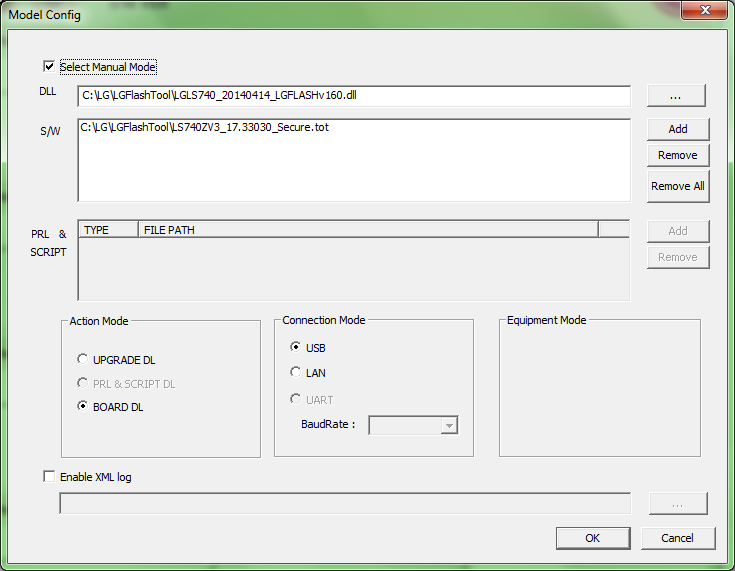

Step 3 - Flashing zv3
Open the LG Flash Tool. On the config window, make it look like the picture below
(note the DLL, S/W, and Action Mode) and hit OK:
On the main window, hit the yellow arrow at the far left.
Once it finishes, unplug the cable from the computer, and plug it back in to start the flashing process.
