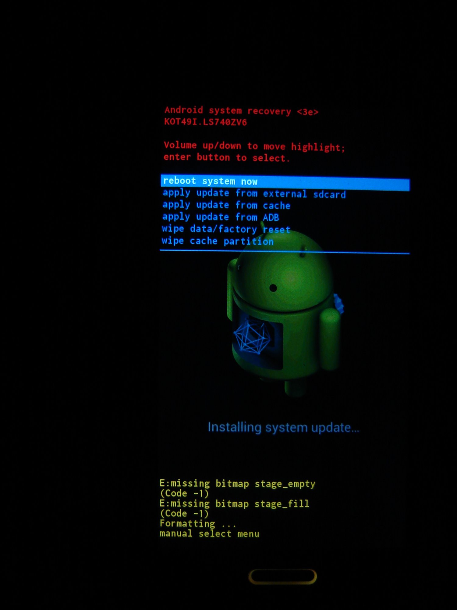

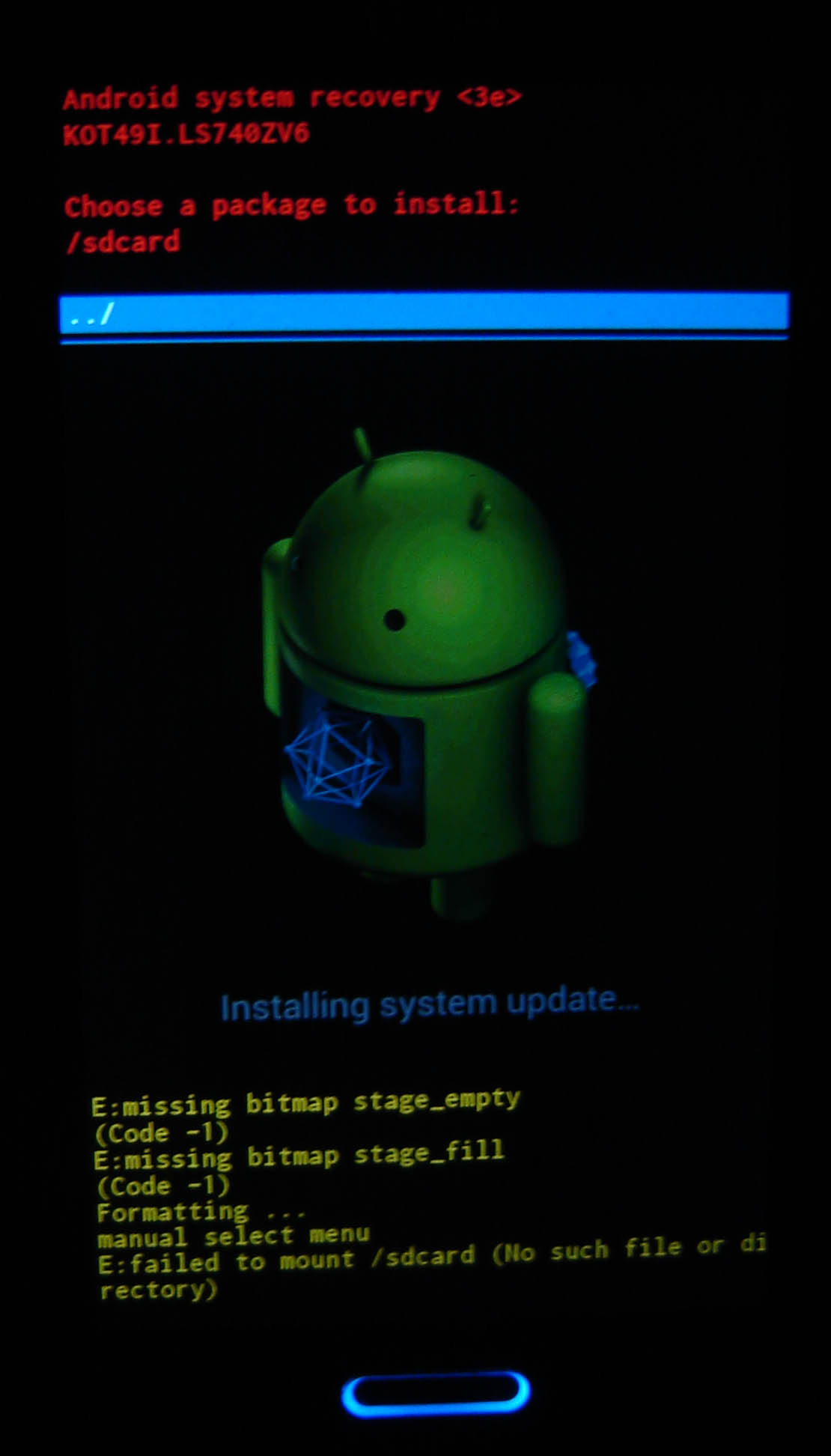

I tried to follow the procedure here to flush any rom back on my phone.
The download mode never shows firmware update (do not unplug the USB connection untill this process is complete) screen. Download mode just sits in --portchange-- step (see 01.jpg) nevermind how long do i press volume up key.
I also tried to do something in Android System Recovery <3e> but see 02.jpg what happens there,
if i try to access sdcard, i also get "failed to mount /sdcard (no such file or directory)" or "(Invalid argument)", see 03.jpeg.
Can this phone be saved?
The reason you don't have download mode is because you zero out your laf partition with the download mode on it! Thus replacing Download mode with the fastboot screen you see here! To fix this just take boot into fastboot and use the adb tools and flash your laf.img backup you made (or at least I hope you made) and get download mode back by using the command "fastboot flash laf laf.img"
The recovery issue is common with Kit Kat builds so that is why you get the error! Custom recoveries are used to get around this
