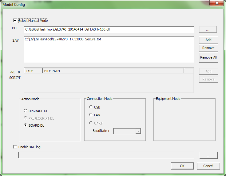

I'm having trouble getting a phone rooted using this guide.
Whenever I select BOARD DL mode, it gives me a "check phone or dll" error. If I select UPGRADE DL mode, it goes through, but then gives me a Factory Reset Status 2 error on boot.
What should I try next?

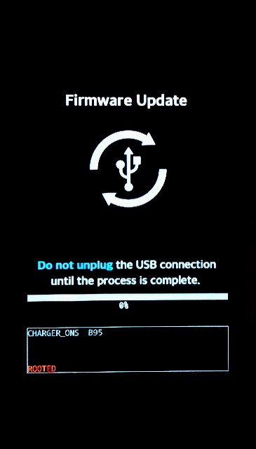

With the phone off, and USB cable plugged into your computer, hold Vol + and plug the cable into the phone. (Some drivers may install, allow this to happen.)
Continue holding Vol + until download mode loads. See screenshot.

Open the LG Flash Tool. On the config window, make it look like the picture below
(note the DLL, S/W, and Action Mode) and hit OK:

Every time I go into device manager to try and change port to 41 its telling me that I dont have write privillages in the registry for this device even though my phone is set to developer rights and I have usb debugging checked, using windows 7 getting frustrated please help.
hanks to everyone else who contributed time and knowledge to getting this stuff worI
Has anyone had issues with Win 8.1 on the mobiledrivers. Im new and i can't even do the first step.
I did step 2: Setup your computer but i keep getting authorization errors.
Ok can someone tell me why when I go into device manager to change port to 41 under port settings I click on advanced I get a message saying that I dont have write privallages in the registry for this device........ using windows 7 please help really frustrating!
