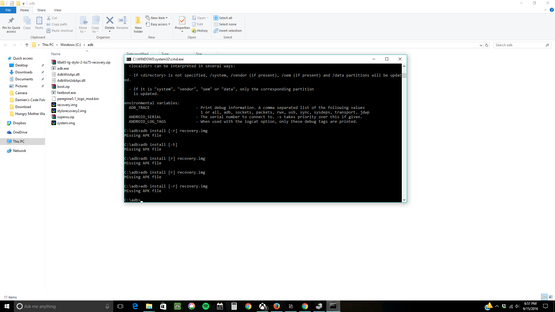

Playing around with the phone today, I tried a few adb commands and got what you see in the below screenshot. @ GOD, is there anyway that you may be able to compare zv3 and zv4 and see if there is an .apk file in zv3 that is not present in zv4? Just a thought.
I Don't Understand The Question,You Want Me To Look For any Differences In System Files On Both Zv3/zv4? :confused:
