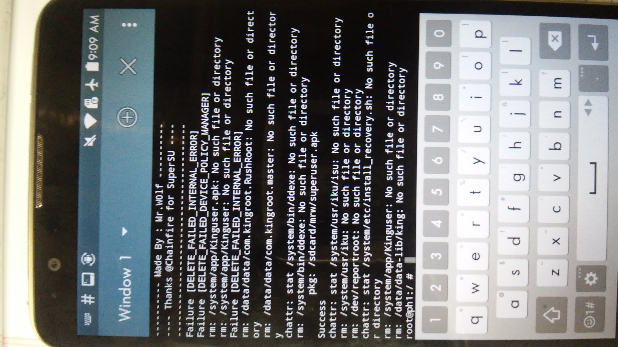

I think mine doesn't work because of the errors I'm getting on the first part of the process under terminal emulator.
