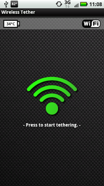

Done, wireless tether for root works great. Took all of fifteen minutes including installing the sdk which i didn't have on this computer. Thanks birdman and the entire development community.
