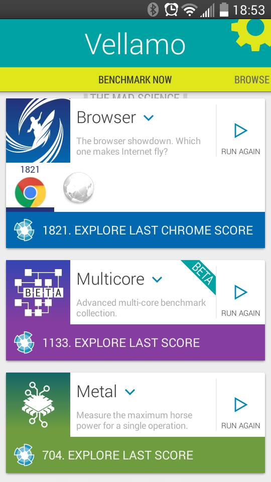

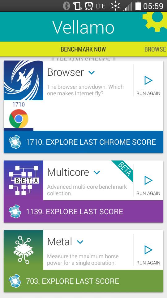

Went through and basically completely unmodded the phone. Unlinked apps, uninstalled link2sd and xposed, moved apps I had made system apps back to user space.
Flashed the odexed ROM and aside from a couple play services at first boot all seems well. Even switched over to ART runtime. I ran a couple benchmarks with an app I found from Qualcomm, before, and after updating. I will do another after I debloat, but here's screenshots. The first is before, the second is after. The browser score jumped way up, and one of the tests that failed before updating completed this time. Might run it on the stock browser too, just for curiosity.
