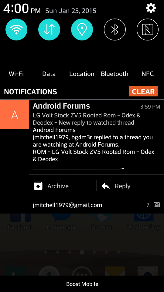

Some screenshots of my Lg g3 launcher and quick settings
