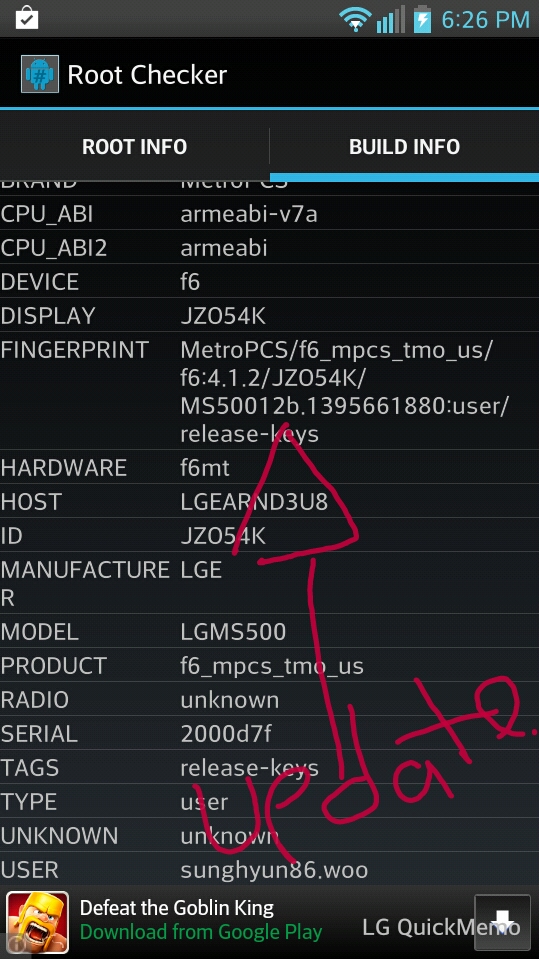

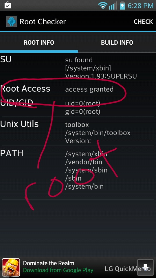

screen shots

Ok so i got root with the new version. when i did framaroot it just disappeared after i hit gandolf not sure if that was supposed to happen. when you do kingo i did it under camera and that worked hope this helps some of you
