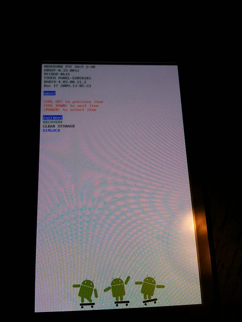

So I rooted successfully and removed bloatware successfully and was feeling pretty confident. I found a ROM that I really wanted to flash so I followed the directions the directions to a T. I installed the rom and superwire on my card, did a nandroid, wiped the 3 things on the list, ran the super wipe, then flashed the mod... Everything seemed to to work out ok, even the build is listed at the bottom mof the bootloader. But when I hit rebook system now it takes me into revolutionary, which gives me the same options and send me back to android system recovery. So I'm thinking that whilst I rooted using one preferred method, I actually did again with another method whilst flashing this mod.
I've tried every combination of button but nothing will start the phone...Please help me,
Everytime I try to restore the nandrois it say's"couldn't open the directory/SDCard/nandrois/e:couldnt open directory"
like the pic, not exactly but pretty close

Edit: Do what argedion saisd first, if that doesn't work, try out what I have below. :)
Ok, what you have probably is a phone without a rom. It will only boot to the bootloader because there isn't anything in the boot.img partition.
What rom did you try to flash?
Can you restore your nandroid, did you make one?
First, go back to where you downloaded the rom, and redownload it. Go under your recovery and select mounts and storage, select mount sd.Delete the old rom file and transfer the new file to your sd card. Unmount your sd card, then wipe everything again. Flash the rom file again and see if it will boot.
If not, try out another rom.
Remember if you can get into the bootloader or recovery, you have a 99.9% chance of recovering your phone. ;)
