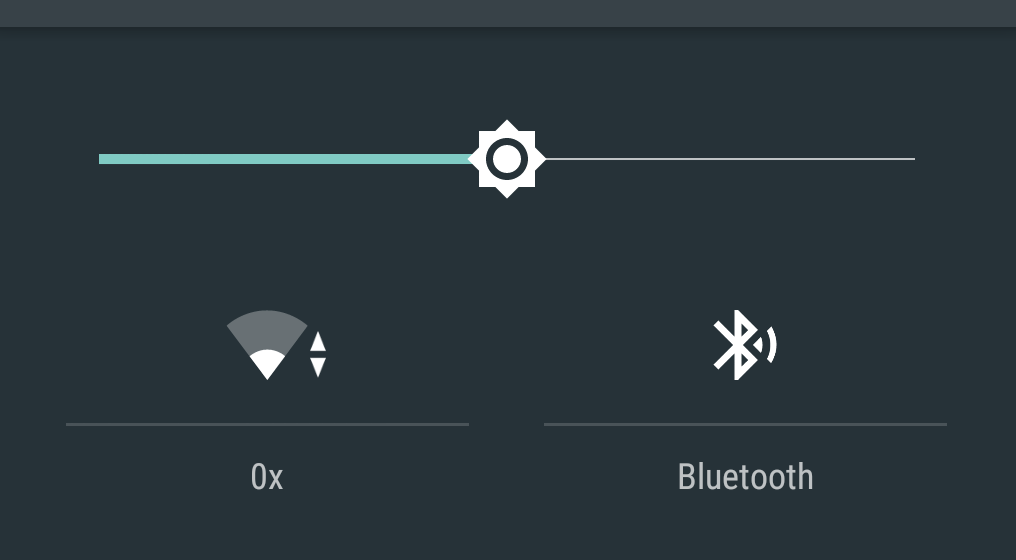

This problem happened to me since always on CM13 (plus WIFI turn off when the screen is sleep), WIFI shows 0x sometimes - MS323
Yes, those are known issues, you can check the remaining bugs currently affecting each model on cm13 on another thread.
