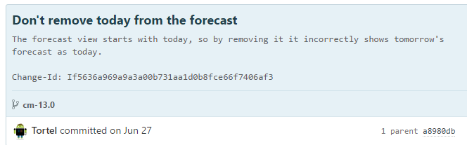

This change: https://review.cyanogenmod.org/#/c/151480

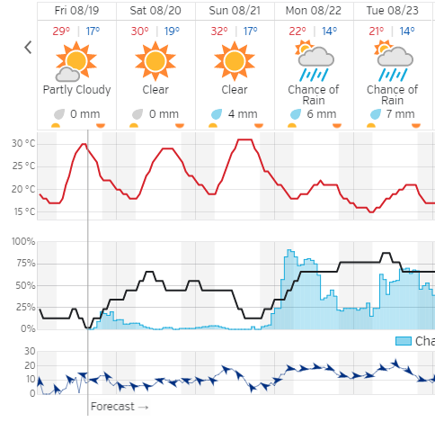

doesn't have effect in my phone, anyone got same problem?
