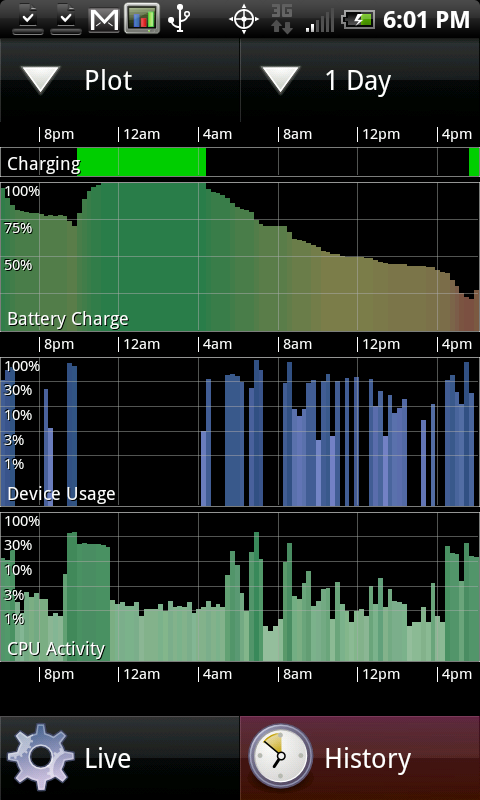

I've gone all day, since 6:45AM and am getting ready for bed now. 9% left. Survived the entire day. Moderate to heavy usage at times. I even put my Facebook Widget back on the home screen.
Hmmmm, everything seems to be running pretty stress free while I look at the System Panel app. Only two things that are showing any use at all is the System Panel itself and Voice mail uses like 1s of CPU. Today I got excruciating battery life. It was like 5 1/2 hours with very little use of the phone. I did turn 4g on for a bit cause it was on in Hollywood, but I didn't really use it.
Also, if the Facebook app doesn't instantly send your phone push notifications than what exactly does it do in the background? I have never once seen anything come through from Facebook, even when its sync is set to every thirty mins. I have to go into the app, and even then I have to REFRESH MANUALLY any notifications. Just curious what syncing Facebook actually does with my phone...(besides add 495 people into my Phone app.)
If application processes aren't using a lot of cpu then check your radio and other hardware device usages. You can find that under the 4636 menu or get the "phone info" app to make a shortcut to it.
I guess I dont really know how to interpret that information yet. I was looking under battery history at CPU usage. Not too sure what to make of it really. My phone definitely doesn't last long on a single charge, but half the fun for me is figuring out why.
