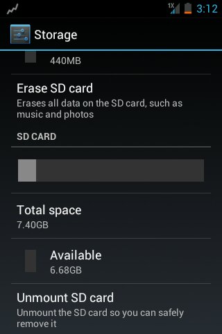

@Ken, what did you end up doing? (Looks like it took all your battery to do it too).
i can only charge my phone at certain times thru the day.
what i did was change vold.fstab
the second entry /mnt/sdcard was set to an absolute mountpoint and i changed it to auto plus the two lines were put together so i *think* the system was reading it as one command, I seperated the two and allowed the sdcard to mount at the first available position. It shows up just fine now but its still a wip, my linux scripting skills aint what the used to be since i lost my laptop so i'm still cleaning it up. its kinda messy lol
right now its showing i have two sdcards mounted, i want to try to change it to where it actually is labeled something like 'internal' and 'external' or something like that.

If anyone is interested here is what I changed it to
dev_mount emmc /mnt/emmc 15 /devices/platform/msm_sdcc.2/mmc_host/mmc0
dev_mount sdcard /mnt/sdcard auto /devices/platform/msm_sdcc.4/mmc_host/mmc2
If you do this its HIGHLY recommended to download zarchiver from the play store. Extract the file from the cm9 zip, modify it, replace it and reflash. It may not be a good idea to change it on a working system. Also make sure you have backups.
Its located under system/etc
Then just check internal storage under the storage settings and that's it

No, but I didnt just modify and reboot. I modified. Added it to the zip and reflashed
Plus fstab only controls partition mount points, it has nothing to do with data connectivity
